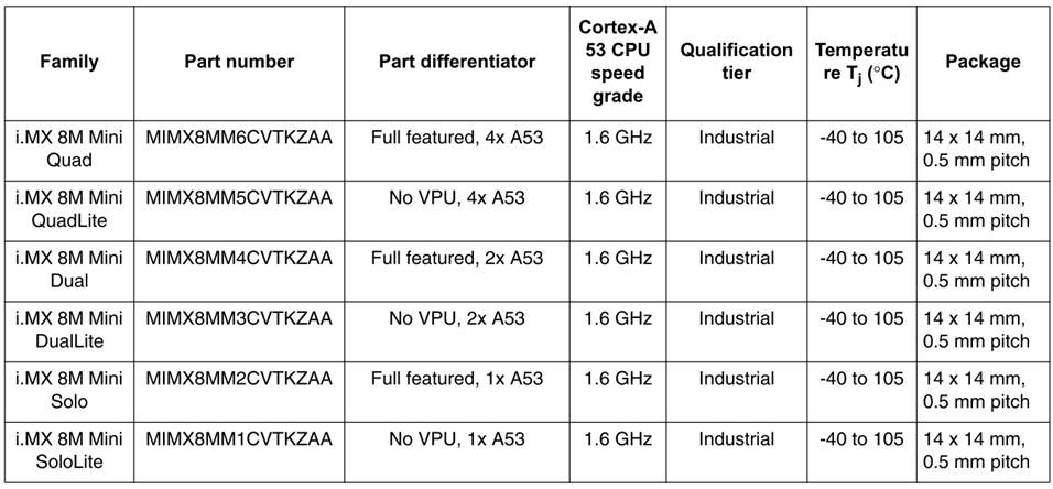

Power solutions for SOC's and processors usually depends a lot about the needed maximum currents. As for i.MX8, different versions needs a different power levels so one power tree for high end full featured version might be not the best for lower power level version.

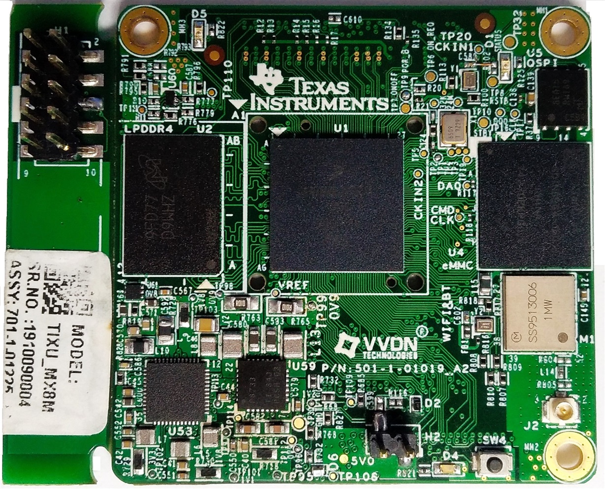

Powering the NXP i.MX 8M Mini with the TPS6521825 and LP873347 PMICs
We are updating part number from TPS65218D0 to TPS6521825, which is pre-programmed to work with LP873347.
This board has been built and we are working to release as Reference Design:
The SoM board is compatible with the existing 8MMiniLPD4-EVK from NXP.
