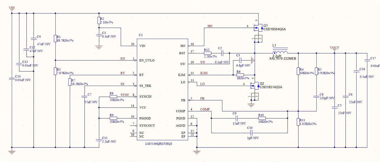

A new project needs to output 15v10a for 24V power input. LM5145 is considered.
The design is shown in the figure below.
Q1 is burnt out when it is designed and used.
After Q1, Q2 and L1 are removed, the oscilloscope tests that HO is 6V and LO has 540K pulse signal.
Please help me to analyze. What's the problem?
