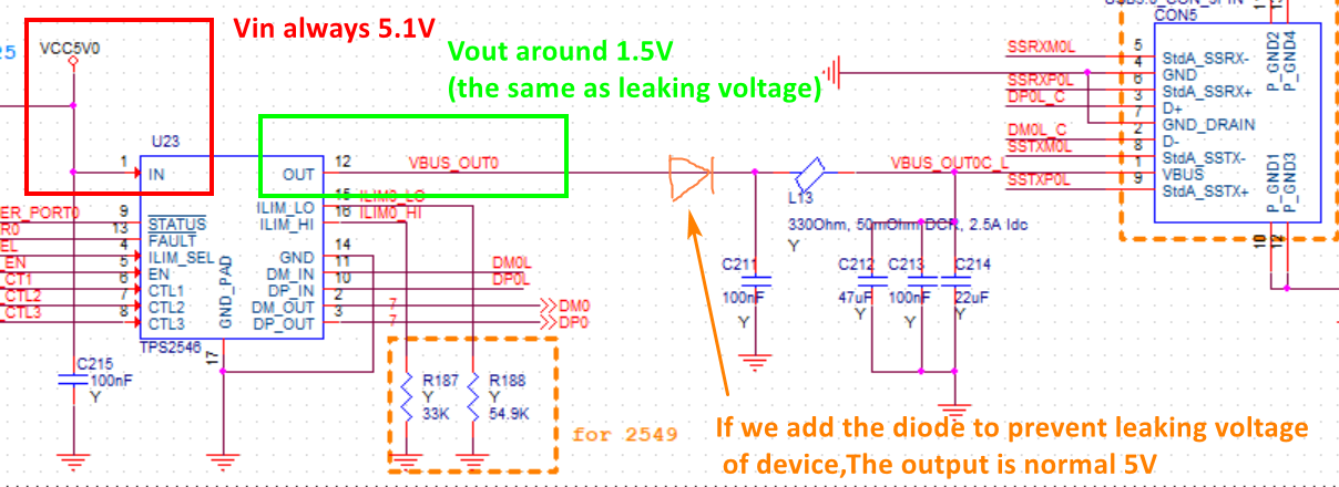

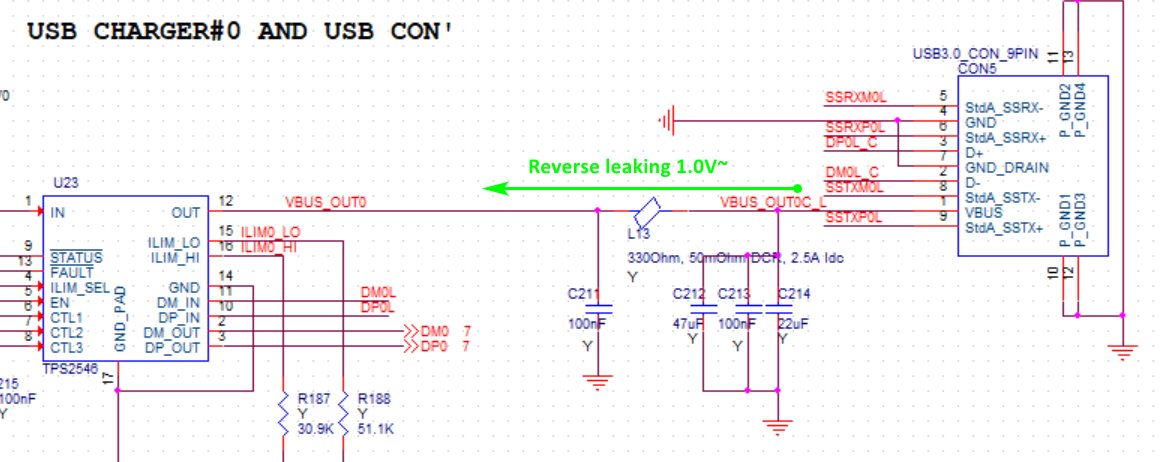

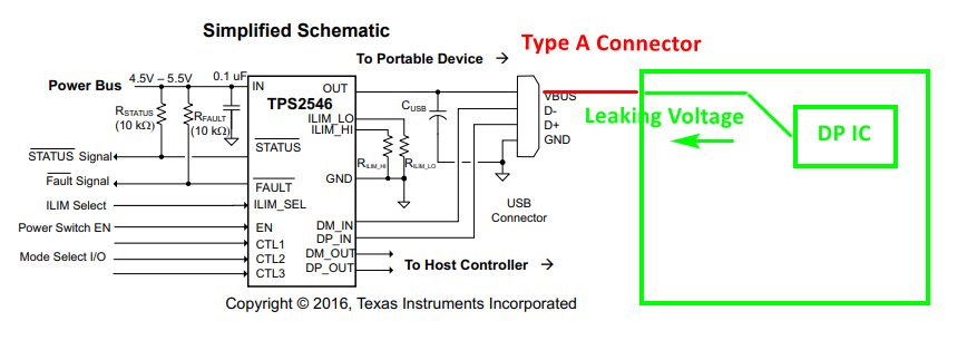

Here is our circuitry and we found a situation where Vbus_out has no output voltage.

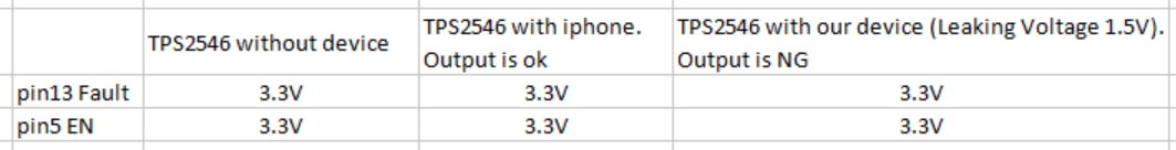

The situation is:
When unusual device has leakage voltage (around 1.0~1.5 V) back to TPS2546's pin12 (Out) , and then Vbus_out has no output voltage.
a. Is it normal ?
b. Could we have the way to solve it ? (No hardware modification)
