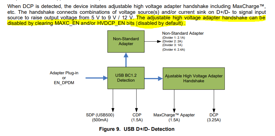

My customer is surveying an MaxCharge default disable version of BQ25895,
seems like the BQ25895M is the solution right?
Andy
Hey Andy,
That's correct. If you are not looking for the MaxCharge handshaking to be enabled by default, this device will work well.
