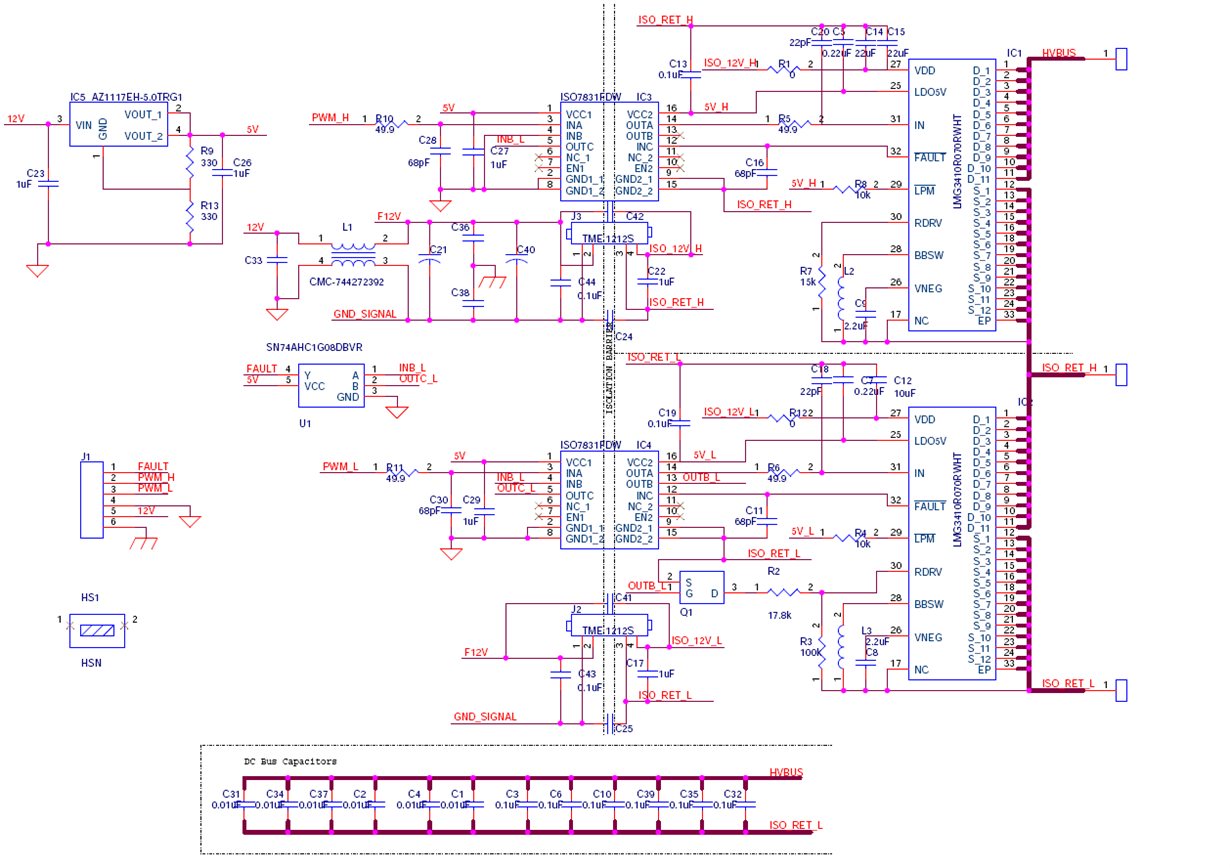

We designed one half bridge module using LMG3410RO70 using the reference from TI. We used it for synchronous boost converter operation. We tested it with open loop configuration. It was working fine when the input voltage is below 30V. But when we increase the voltage above 30V the upper device is not properly switching on and by further increasing 10 more voltage the upper device failed (not getting the 5V from LDO inside the GaN device). Please find the attachment for GaN half bridge schematic and Device voltage waveform. In the wave form you can see that there is a shift in the voltage level during turn on.

  • Hello Jidhun,
    This is a follow up on the previous reply. Assuming the green curve is the input signal, then the signal is too noisy with some unintentional turn on due to potential ground bouncing.
    Looking at the schematics, the TME1212S component should give you the isolation needed. C42, C24, C41, C25 are unnecessary and could be the cause of the ground bounce. Try to remove those 4 caps and see if you have the same problem.

  • Hello Jidhun,
    Could you please share the layout near the high side GaN? The parasitic inductance and capacitance from the PCB could also cause undesired noises if the layout is not optimized.
  • Hello Yichi,
    Please find the attached layout file for your reference. Kindly verify it.Layout of Half bridge GaN Module.pdf
    Jidhun
  • Hello Jidun,
    The layout has several issues leading to the noise at the high side PWM:
    • (Primary reason for the noise) There is no shielding polygon (connecting to Vsw)under high side device and its surrounding R/C/L. The high side PWM has large ground return path from Vsw of GaN to Vsw to the isolator.
    • Under high side GaN, there is a polygon connecting to the power ground, not high side signal ground. The polygon cannot help with the signal shielding but add CM noise into the low side signal.
    • Please refer to our EVM on our website as a layout guideline.
