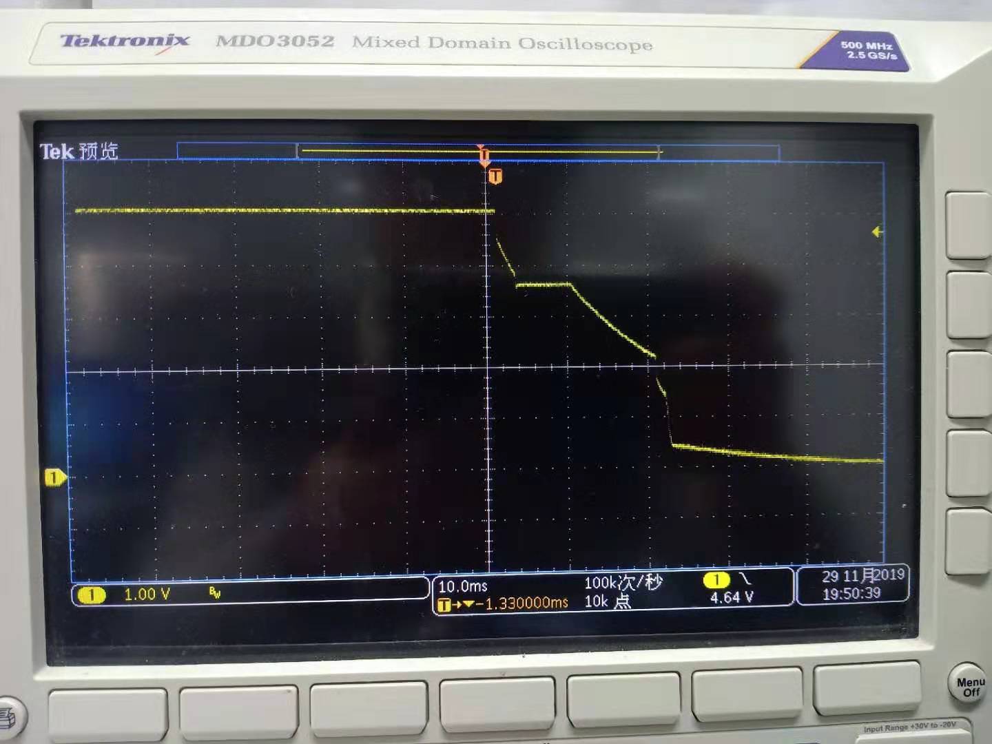

When charge closing to complete (battery voltage almost 4.2 V), after we removal Vbus attached to BQ25890's VBUS pin, there have a chance that the BQ25890 will reverse output a weak 4.4 V to VBUS pin (the charge more close to complete, the issue's appear chance is grater), that cause BQ25890 don't know the VBUS was removal, and won't generate an interrupt to tell our system's CPU, and CPU won't send charge disable command to BQ25890, so the BQ25890 stay in this weak reverse boost state, sometimes this state will last about 5 seconds, sometimes this state will last forever. The Vbus wave form as below:

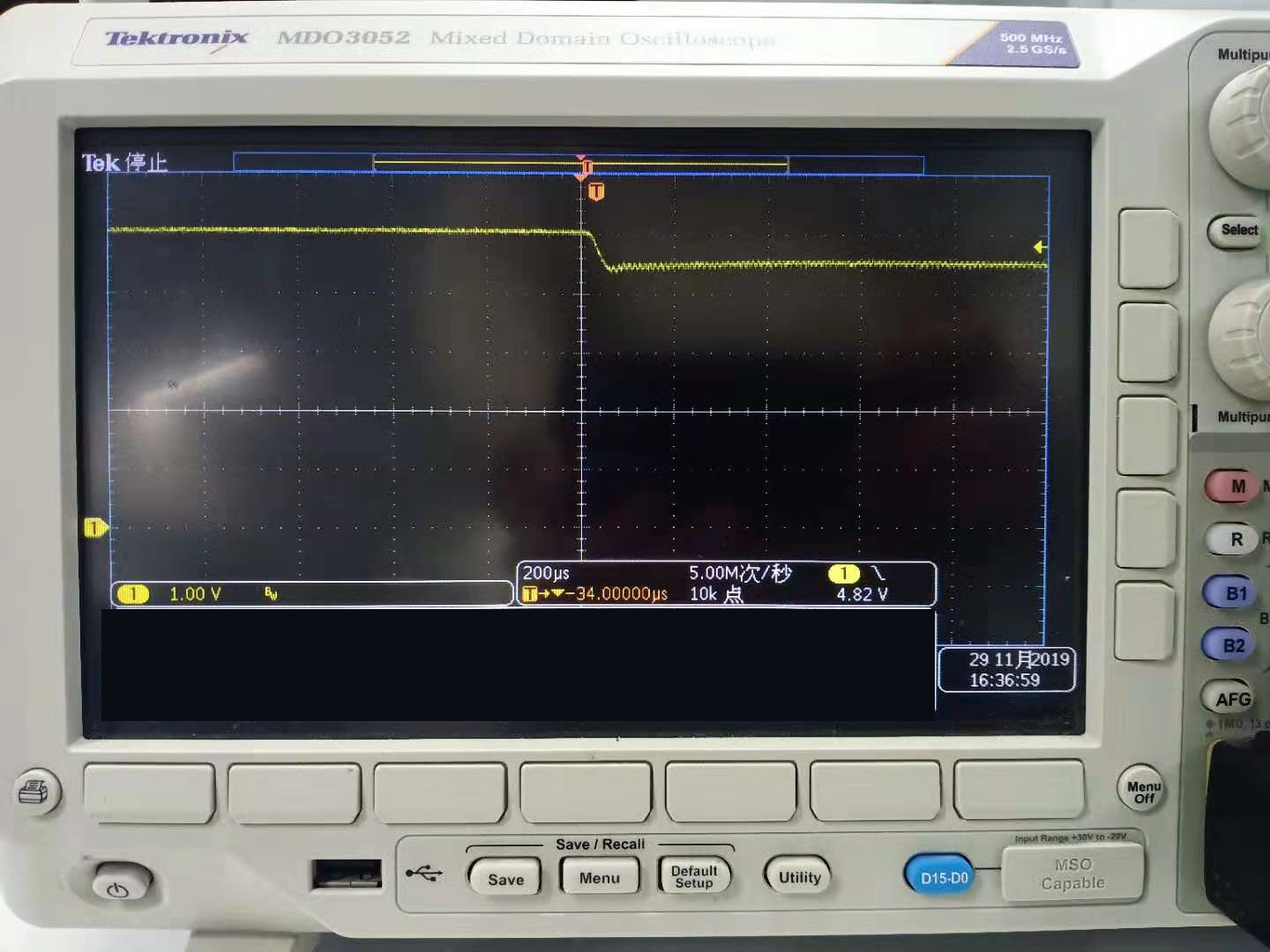

Sometimes hadn't appear this issue, after VBUS removal, we can see the VBUS also not drop directly, the wave form as below:
In that abnormal state, I measured BQ25890's OTG pin, it's low, and its "SW" pin have switching wave form, so the 4.4 V voltage should be reverse boost by BQ25890, but not controlled by OTG PIN.
The output 4.4V is weak, when we add some interfere to VBUS pin, like use an electronic load to sink 1 mA current, the 4.4 V will disappear immediately, and BQ25890 will generate an interrupt output by INT pin, and  quit this abnormal state.
The abnormal reverse output  voltage will follow VINDPM setting change to change, after we change VINDPM to 4.5 V, the VBUS abnormal reverse output voltage will be 4.5 V, and set VINDPM to 4.6V, the VBUS abnormal reverse output voltage will be 4.6 V. But when we set VINDPM to 4.7 V, this abnormal state will not appear, seems all is OK.
I think it's should be when charging current very low, after remove attached VBUS, before the VBUS drop to the voltage level that can generate a Vbus removal event in BQ25890, because BQ25890's switching works continually, it boost battery's power reverse to VBUS, and BQ25890 don't know it, BQ25890 treat this 4.4 V Vbus as input power supply, so it stay in charging state, but it's not charging actually.

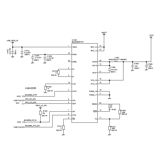

Our schematic as below:
Help to confirm whether you had encountered this issue before? And whether there have some design errors in our schematic caused this issue? How can I to resolve this problem?
