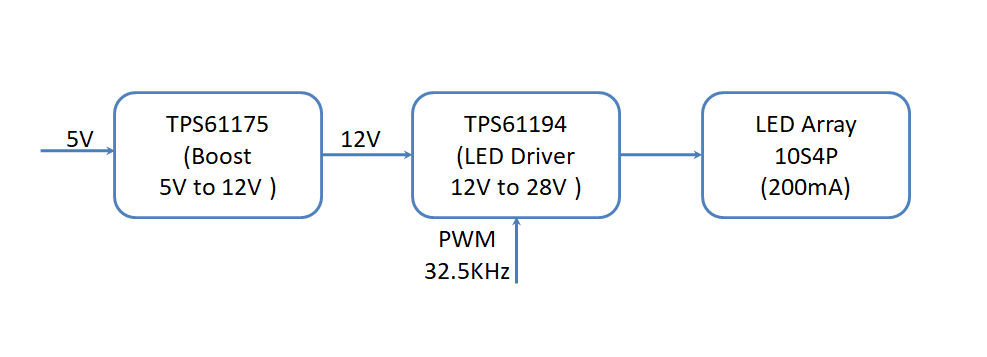

  • Hi Sean,
    I have attached a high-level block diagram of the regulator and LED driver.
    The LED driver and the backlight LED array is on an LCD.
    So we cannot change anything on the LED driver circuit design as the LCD is a standard module which we will purchase from other vendors.
    The boost regulator which I have shown in the diagram is there on our board.
    And we are observing the high ripple voltages on the 12V output rail of this regulator.
    So we have made some modification on this regulator circuit to reduce the ripple to a minimum.
    But the ripple didn't reduce to an expected level.
    And we have observed the ripple reduction with respect to PWM frequency (it is the only control we have on LED driver circuit).
    As I informed in the previous post I have tested with 32.5KHz and found the minimum ripple on that frequency.
    We will be using PWM with a 50% duty cycle in normal condition.
    It will reduce to 20% in some condition. Not less than that.
    I want to know that the operation with 32.5Khz will affect the reliability of the product. the minimum pulse width will be 6.14us.
    Whether It will affect the reliability of the product in the long term use or not?
    Thanks & Regards
    Shafeeq
  • Hi Shafeeq,
         Don't worry about the dimming frequency and the only limitation the minimum on pulse is about 0.5us, so for your application, it is should be ok.
    Sean
