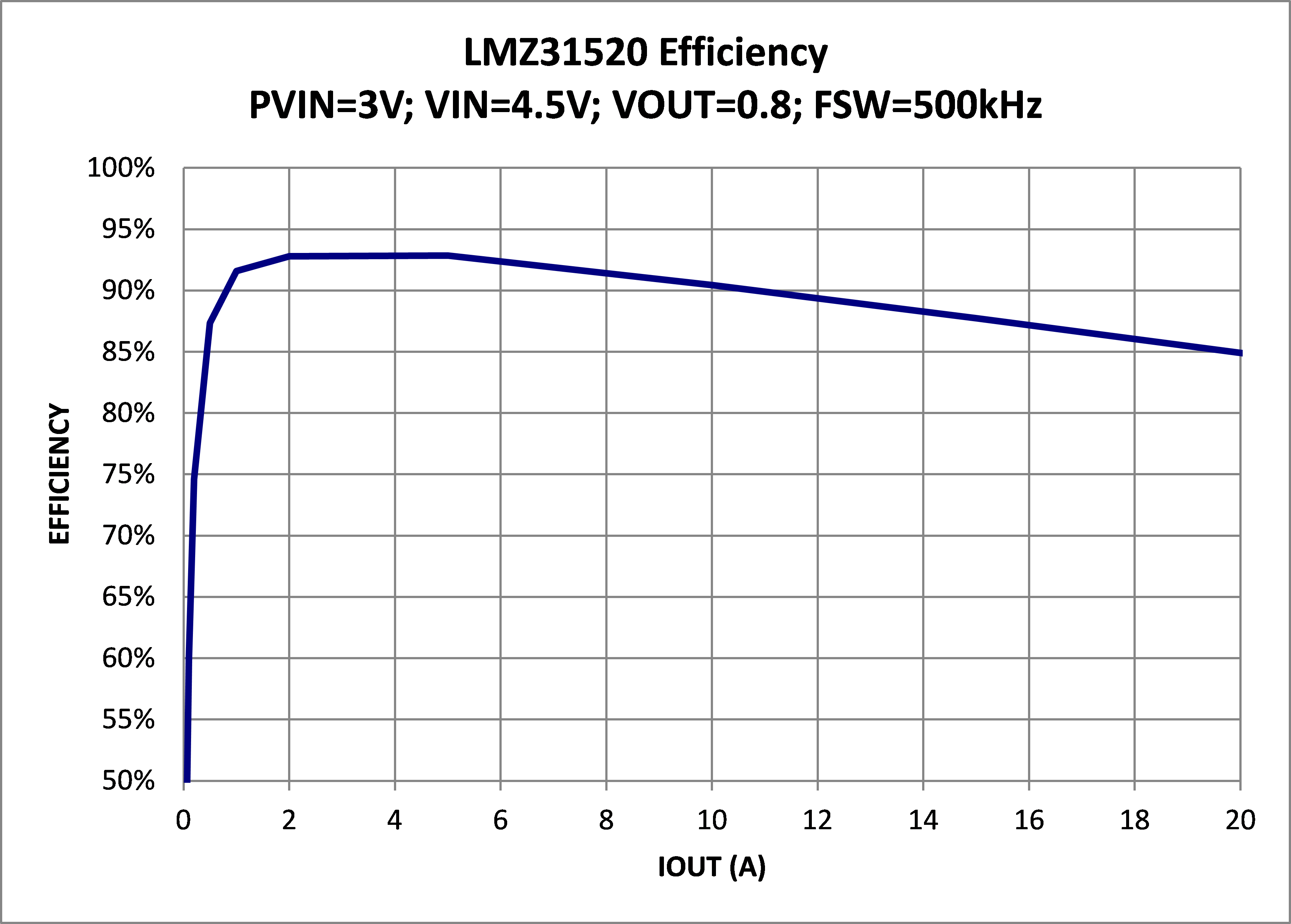

Is there something specific you wanted to see in WEBENCH, for example efficiency at a specific output voltage for PVIN=3.3V & Vin=5V?
As an alternative, I can see if we have measured data already available or take data on an EVM. The first page of the datasheet shows the efficiency for PVIN=3.3V & Vin=5V, Vout=1.8V.
