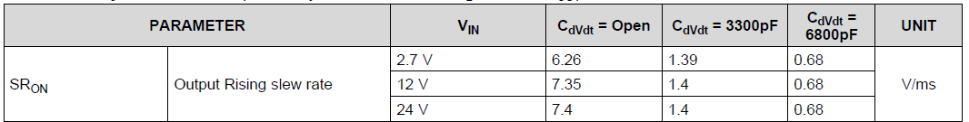

Hello Team,
with a target slew rate of 0.2V/ms I calculate a capacitance of 23nF (used 22nF, C0402C223K5RACTU) but measured 110V/ms.
Even with 4.7nF I got 40V/ms which is far faster than 1.4V/ms with 3.3nF (see below):
Can you explain this, please? Is this part useable for USB3 power? Something is wrong here, right?
Thanks and Best Regards,
Hans

    What I don't understand is that I see faster slew rate with bigger capacitors (see below). 22nF should be slower than 40V/ms, right?
    Is there a limited allowed capacitance range for this capacitor?
    1nF
    190 V/ms
    4.7nF
    40 V/ms
    22nF
    110 V/ms

  • Hi Hans,
    If you insert load (having capacitors) on a live output of eFuse, the eFuse would trip due to circuit breaker event and tries to recover again. In this recover mode, the slew rate is NOT a function of dVdt capacitor. Please verify this by probing current as well.
    For your function, this problem can be solved by using LDSTRT feature of TPS25982.
    BR, Rakesh
