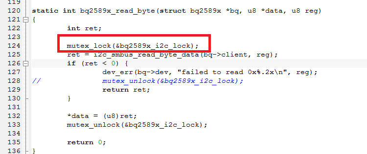

Hi TI experts,
as shown in the figure
What does this function do in the read-write function?The definition of the function was not found
Hi TI experts,
Gary,
It is system API used to lock critical section to ensure only one thread can access the resource at the given time.
