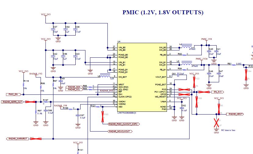

LP87702-Q1: no output from SW_B0 after board ran some time
Part Number: LP87702-Q1
Other Parts Discussed in Thread: LP87702, IWR6843ISK
My customer connected IWR6843ISK to their own system. But after some time, some ISK boards can't work ok. And we found the SW_B0 of LP87702 outputs 0V which is not expected. But SW_B1 of LP87702 works normally (output 1.2V). The resistance value of the inductor L4 (connects to SW_B0) on issue board is similar as the one on working board.
Customer connects the 3.3V power supply/ some GPIO/ UART/NREST signals from ISK connector to their system. No 1.8v from PMIC LP87702.
What may cause such problem? Any comment is appreciated!
Pls find ISK related sch below. You can find full ISK sch in PROC073A(001)_Sch.PDF at http://www.ti.com/lit/zip/swrr164
