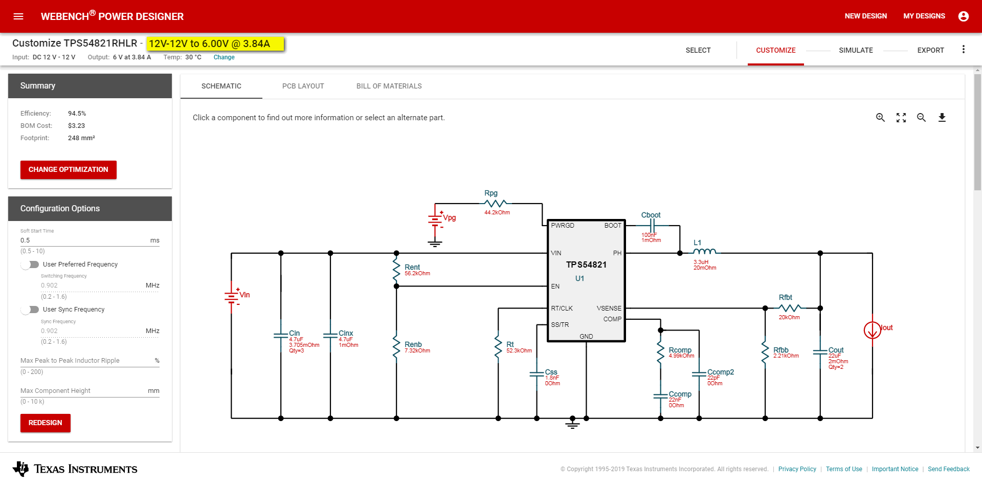

Hi
We are using it for LED Driver power with Vin=12 V, Vout=6 V, Iout=3.84A. We following the Webech result to build the PCB. However see a problem the inductor temperature is very hot. Our schematics as below, can you help review if anything wrong?

  • SJ, As you said if just can't touch it for a long time, that should be not very hot, usually if the temperature at over 50C, we cannot touch it for a long time, if higher to 70C, we only can touch it for a short time. so I suppose the inductor should be not very hot. suggest you test it with tool to get the real temperature for evaluation. and if it is real hot, change a lower DCR inductor instead.

    For the circuit compensation, so far looks fine, let's keep this first, and based on transient test result to determine whether need to fine tune.

  • Hi Yuchang,
    Update temperature measurement data
    Burn-in time = 10 minutes
    Ambient temperature = 22 ℃
    Iout = 3.94A
    TI TPS54821 = 82 ℃
    Inductor VCMT063T-3R3MN5T (Cyntec) = 69 ℃
    The temperature is very high, and the driver is still working.
    Maybe increase layout trace width of ground, improve heat dissipation
    or any suggestions for this heat problem.
  • Can this result be accepted by your system? generally this result is not very high for most system.
    but from simulation, IC temperature only around 56C, so there should be some gap for layout improvement, suggest you can enlarge thermal pad plane, GND plane and Vin pin plane to improve it. also add some vias for thermal pad and GND for multi layers dissipation.
    For inductor, you can select smaller DCR inductor to improve.
