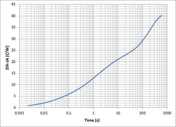

3  There is no transient thermal resistance characteristics in the datasheet. Can you provide it?

    Yes here is the transient thermal analysis
