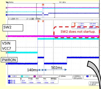

Hi
Our customer has a power-on problem. The output does not startup.(no output voltage) when PWRON set to high at same time of V5IN and VCC7 supplies.
(It startup normally if PWRON assert to high again .)
How much should we make some time (wait time) until to set PWRON high after V5IN and VCC7 is supplied?
Could you give us any condition to set PWRON to high if there are any other condition?

  • Hi

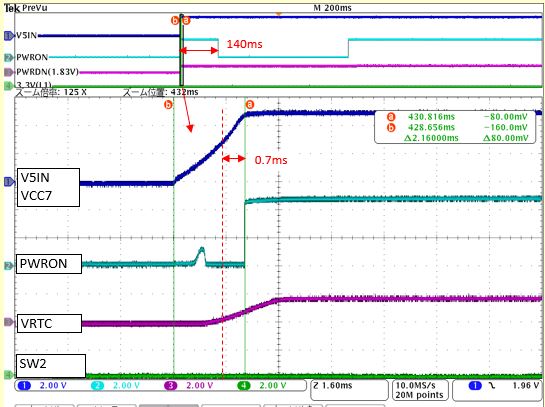

    I got new info for this issue. Please see the following waveform.
    PWRON set to high at the following timing. Is this possible timing?
    Or could you give us the correct timing if this timing is not acceptable?

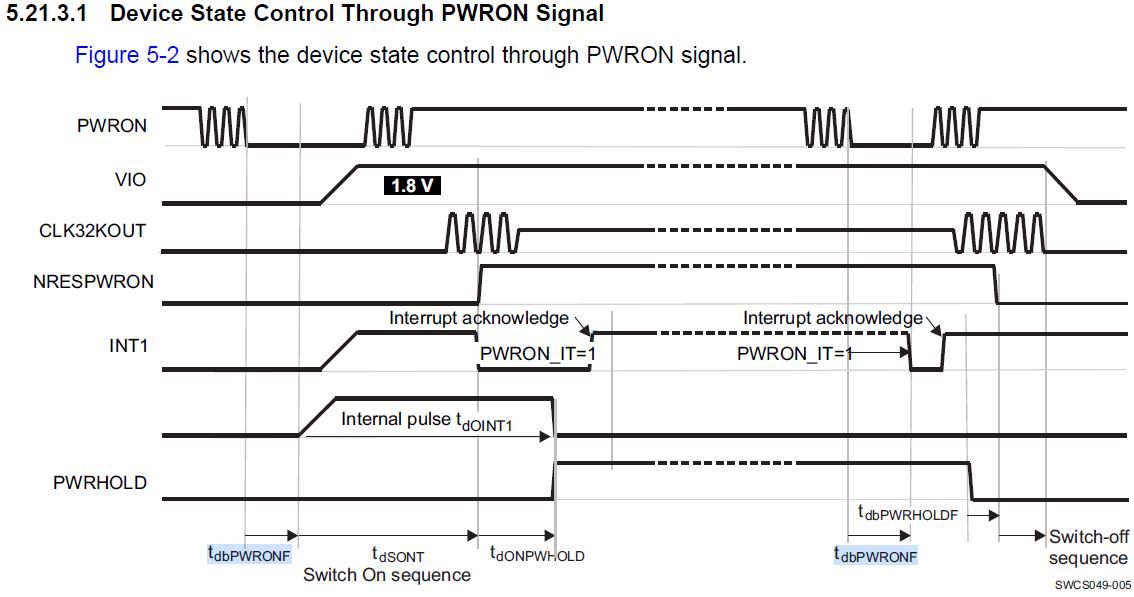

  • Hi, Koji,
      Please check its datasheet section (copied below) for normal PWRON signal active level:
    6.5.1.1 Device POWER ON Enable Conditions
    The device POWER ON enable conditions are as follows:
    • None of the device POWER ON disable conditions are met.
    • PWRON signal low level
    • Or PWRHOLD signal high level
  • Hi Phil,
    I am sorry. My explanation was not so good.
    I understand about Fig 5-2.
    Our customer sequence is as I attached above.
    The customer requirement is the output of PMIC should be startup with PWERON signal after V5IN and VCC7 startup.
    BUT, the issue for some sample the output (SW1 and all other output ) does not startup at the above sequence.
    So, my question whether there is any sequence between PWRON signal and VCC7(other power input) or V5IN .
    or Which power supply must be turned on in advance to accept the PWRON signal input?
    For example, do we need to make some wait time of PWRON signal after or before VCC7 and V5IN startup?

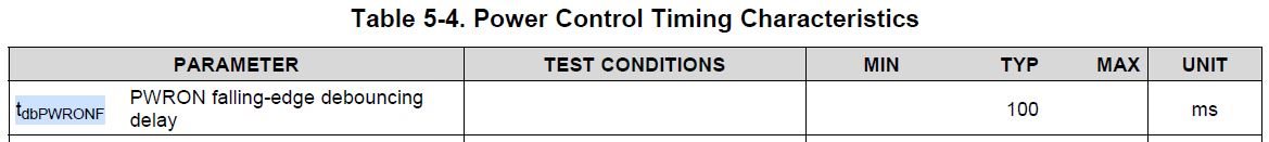

  • Hi, Koji,

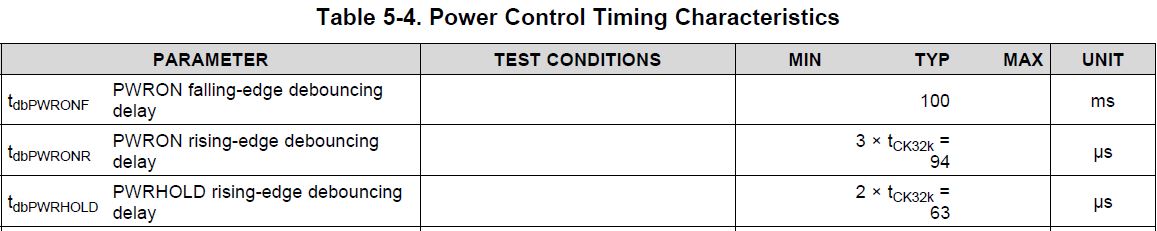

      The PWRON input is designed for the external button to power on/off the device; it needs >100mS low level to power on/off the device with VCC7 and V5IN normally presented; it's not a reset or enable signal to make the device in active mode.
      It looks like the cold reset input signal HDRST should be used in customer's design; the reset release (falling edge) generates a POWER ON enable condition during a fixed delay tDOINT1.
      Please let's know if you have further questions.

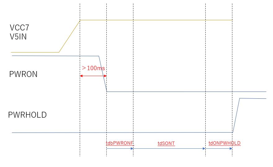

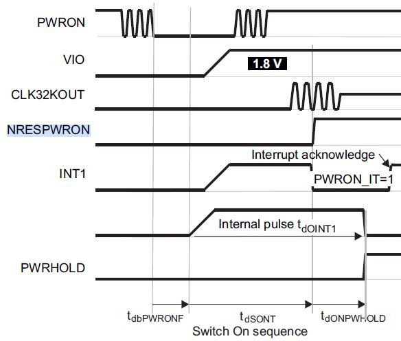

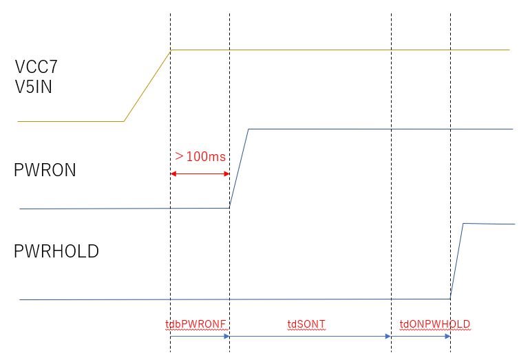

  • Hi, Koji,
      From what you told and what I see, following sequences are needed:
    1.  With VCC7 (V5IN) and all other input power supplies presented.
    2. PWRON signal needs to be low for at least 100mS and then rising and staying high.
    3. PWRHOLD signal needs to rise high after the "Switch On sequence" as showing by pictures below:

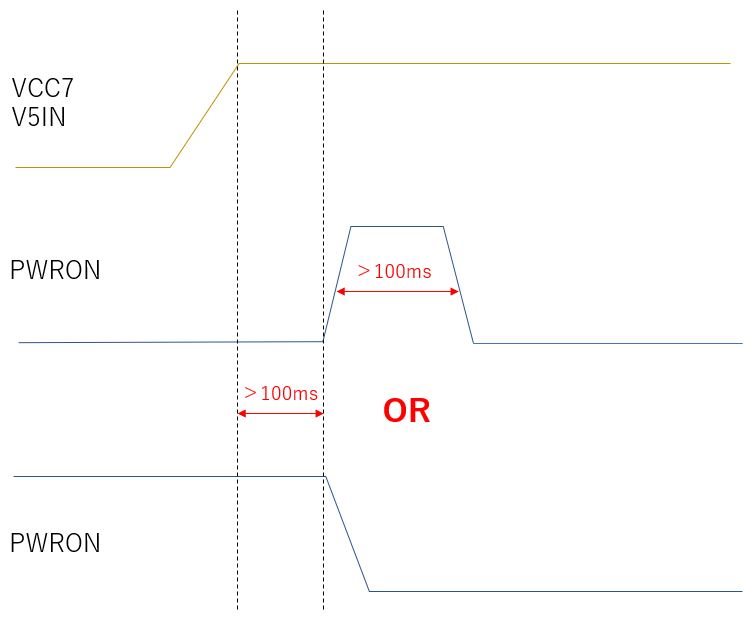

  • Hi Phil,
    Thank you for your reply.
    The sequence you answered is as bellow, is this correct?

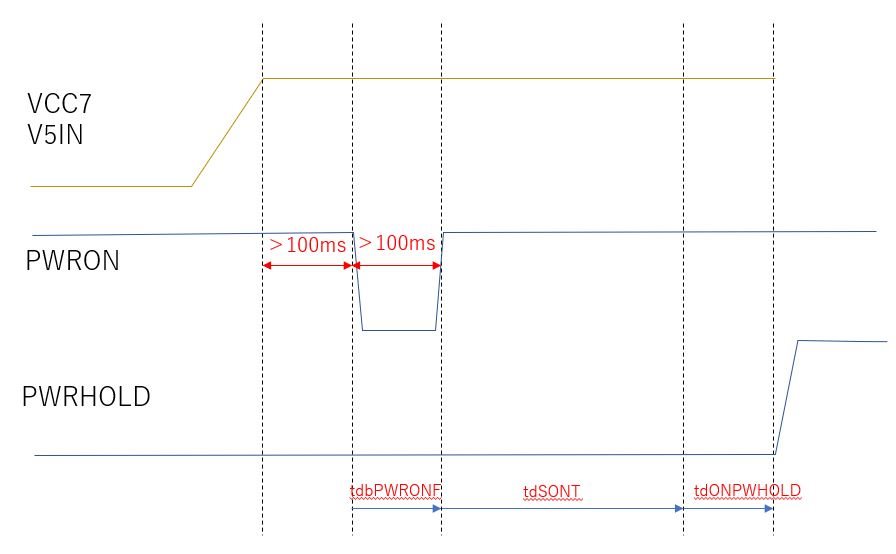

    If so, for example how is the following sequence?
    Because on the customer board PWRON signal is normally high (pulled up) during the power supply applied.
    So , PWRON signal will be the following sequence on the customer board.
    Is this acceptable?

  • Hi, Koji,
      I'm sorry for the late answer; but unfortunately, the answer is: No, PWRON must be high when PWRHOLD rsing up.
  • Hi Phil,
    I appreciate your answer. But it is bad news for me.
    Please give us a little more detail as we need an explanation (solution) to the customer.
    Is it okay if PWRON stay high when VCC7 is started up, as you said PWRON must be high when PWRHOLD rise up?
    For example, are the following waveform acceptable?
    Koji Hamamoto
  • Yes; the waveform you provided meets the power up sequence.
