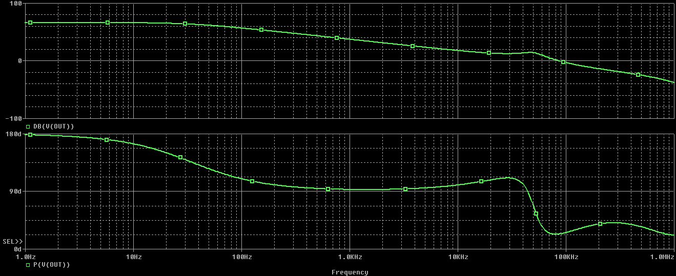

I have downloaded LM2852X average model, ran test cases for heavy/light load conditions.
The results obtained are same, please provide clarification if the model works in both CCM and DCM or only CCM.
Obtained results are attached below for your reference.
Image1: vin=4.175 vout=0.8 fs=default Load current=1A
Image2: vin=4.175 vout=0.8 fs=default Load current=0.1A
I need to align internally and I will get back soon.
