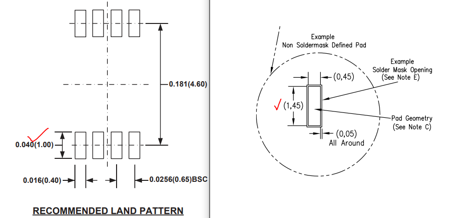

I am looking for P2P with MP1542.
I find LM3224 maybe a right solution for me, but have little concern about device package.
Is MSOP8 P2P with our 8 lead VSSOP?
