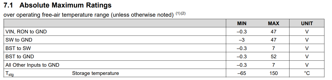

LM3150: Absolute Maximum Ratings at "All other inputs to GND"
Part Number: LM3150
Hi team,
This is the Absolute Maximum Ratings from the datasheet.
I think All Other Inputs means EN, FB, SS, and ILIM.
I know it's expected under 0.7V at SS pin. https://e2e.ti.com/support/power-management/f/196/t/841998
However, Is it really that the ILIM pin need to be under 7V? I think the voltage at the ILIM pin is close to the voltage at the SW pin during on-time because voltage drop of RLIM is much smaller than SW voltage.
