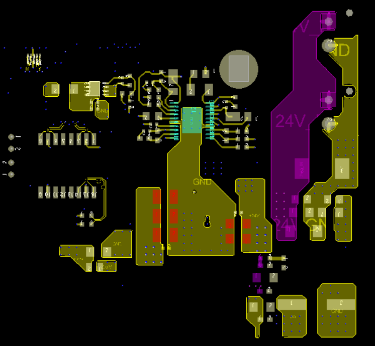

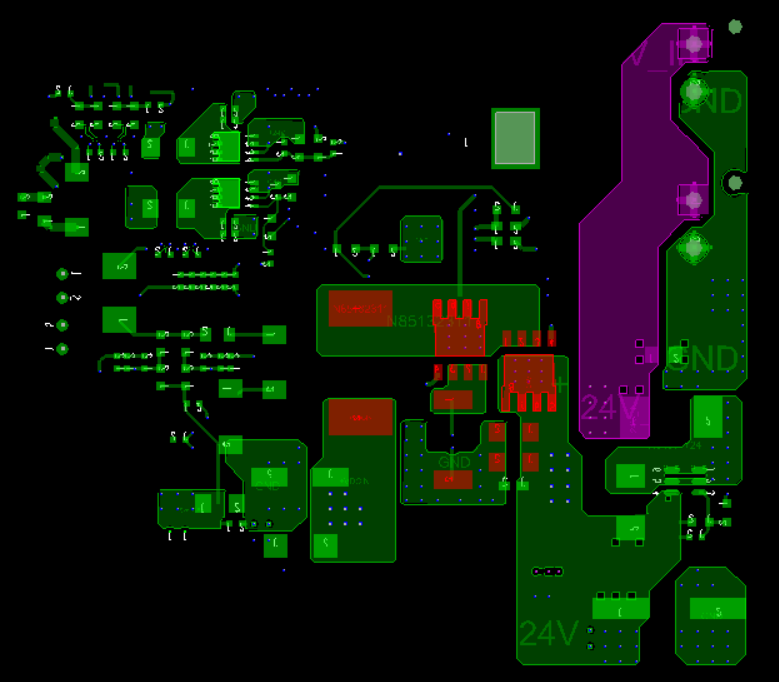

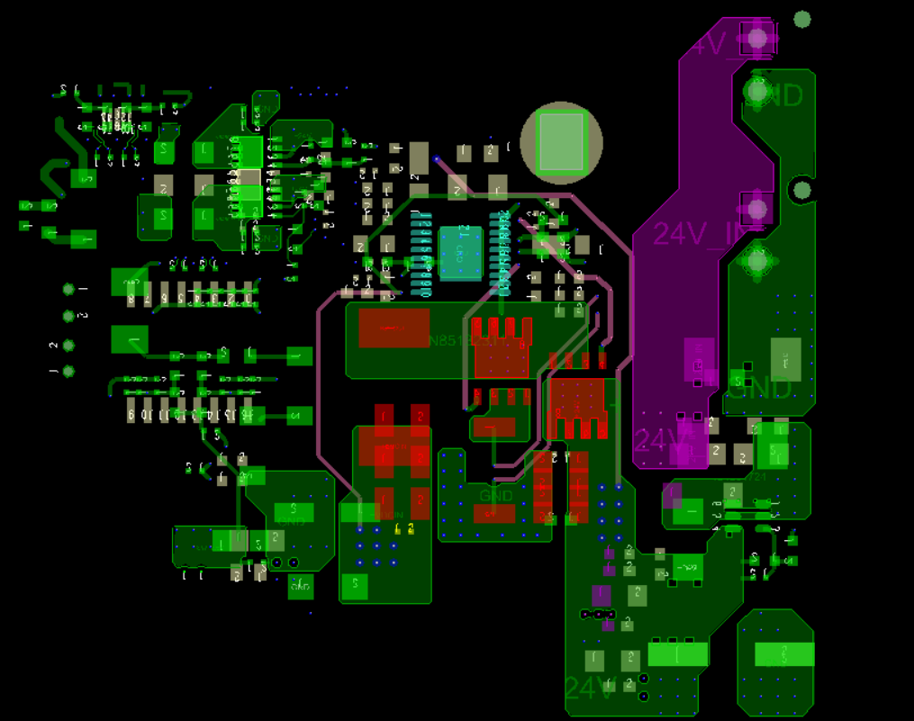

Please help to review this PCB. This is a 10 layer design, but only keep LM25116 related . my customer put the device on bottom layer, but put FETs at the top layer. I can't tell if this may cause some problems. please experts help on this. thanks.

    This is a urgent case, No schematic check need, I've done. just help me out the PCB layout question below , thanks.
    "my customer put the device on bottom layer, but put FETs at the top layer. I can't tell if this may cause some problems."
    you can use below free viewer to open this PCB.
    Download Allegro Free Physical Viewer 17.2
    free tool is limited to turn to pdf, Just put some screenshots here:
    top layer:
    bottom layer:
    mix:
  • I do not think that it is a good idea to put the FETs and controller on different sides of the board.
    The inductance of the connections through the vias may cause some issues.
