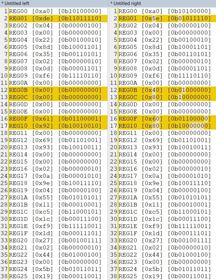

  • Here is a register dump.
    On the left is VBUS plugged in. ADC, Charge, and Interrupts disabled. HiZ enabled. No current draw.
    On the right is after unplug/replug. HiZ has been cleared and current is being drawn.

  • Rocko,
    I understand the ADC enabled/disabled behavior a bit better now. BQ25883 is designed to remain in HIZ until the VBUS voltage rises above VBUS_UVLO_RISING again. The ADC workaround works because the VBUS capacitor can remain charged for longer with the ADC disabled (~800ms). When the ADC is enabled this capacitor almost immediately discharged (~150ms).
    Quickly unplugging and replugging the VBUS with ADC disabled will go unnoticed, but leaving it unplugged for longer periods of time will result in the capacitor being discharged and HIZ being toggled upon replug. This will not work for your application if you want HIZ to remain active indefinitely when VBUS is unplugged.
    I suggest monitoring VBUS and re-enabling HIZ whenever VBUS rises above VBUS_UVLO_RISING (max) in software.
    Ricardo
