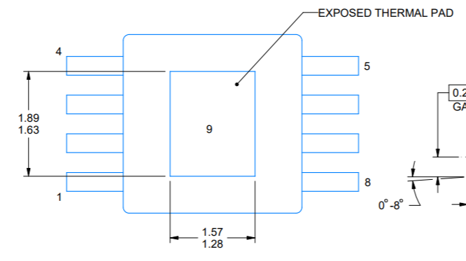

We have a customer seeking for the thermal pad dimensions of TPS7A6650QDGNRQ1, in
HVSSOP (DGN) package. Hoping for your assistance on this.

Hello Art,
Sorry for the trouble. We are working on getting those dimensions reattached to the datasheet.
The pad dimensions are 1.63 mm x 1.89 mm.

Hi Aaron,
I just got a follow-up inquiry from the customer. Below are his questions.
"Which direction does each dimension represent, regarding left to right and top to bottom? For documentation purposes a detailed picture would be best."
