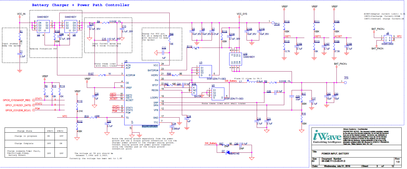

We are using BQ24610 battery charging IC in our board. (input 12V, output 8.4V. Charging current 2A)
When the battery is not connected, there is a ripple of 3.2V is present on the output of the charger IC.
When the battery is connected, the ripple is not there.
Is this an expected condition?
Can you suggest anything to reduce this ripple?
