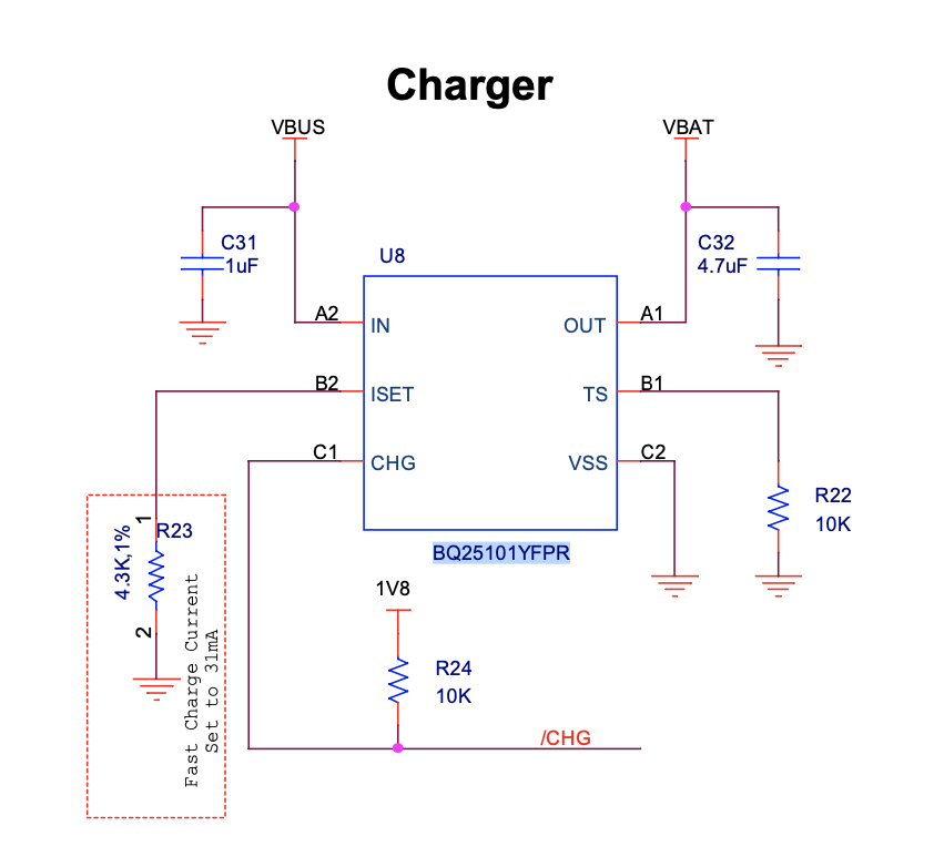

BQ25101: Battery can't be charged when battery is dead
Part Number: BQ25101
We use bq25101 and find a problem for the following condition.
1. PCM of battery is enabled by very low battery voltage.
2. Supply 5v to VBUS.
However, PCM of battery can't be disabled. Battery can't be charged.
Here is our schematic of bq25101
