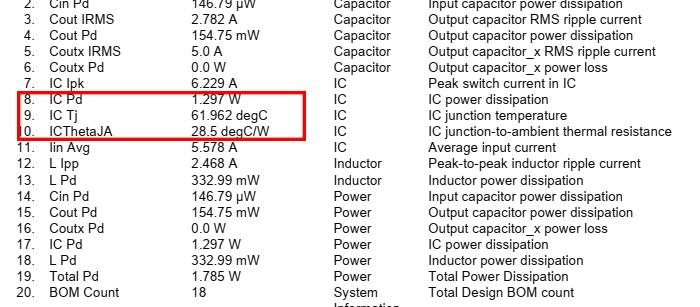

We did the simulation from WEBENCH for TPS61178RNWR.

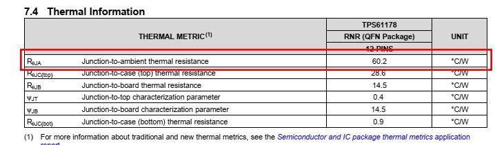

But found the ICThetaJA is different from the number in the datasheet.
We wonder which one is correct. Please help to confirm it.
The simulation result is attached, FYI.
