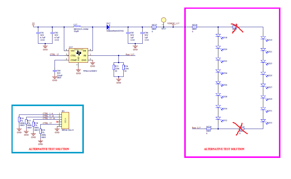

Hello Everyone,
I have recently devloped an product by using TPS61165 which consists of 8LEDS by limiting 20mA current maximum when i provide direct PWM signal (Function genrator) at 10KHz  at 50%duty cycle with 3V3
then led started flickering later i have started changing either the frequency or an input voltage from  Vin 3V3 to 3V1  it is started functioning correctly
again if i increase the voltage from VIN 3V3 to 5V the led no even working  i dont understand exactly how it is functioning even though i have read the datasheet  so many times repeatedly
Could you please suggest me is there is any limitation for this device or any other particular conditions has to be taken into account in order to understand the functionality
is there is any dilemma between CRTL pin voltage and frequency variation with respective duty cycle
Finally i have made conclusion when i provide CTRL PIN VOLTAGE (PWM) between 1.2V TO 3.2V then only led are working other than it is turned off completely for higher voltages why i am having this problem
any help or ideas would be greatly appreciated

        From your description, it is a little strange and PWM dimming frequency should not have much effects on the dimming. But I want to makes ure with you about the output volatge and could you share me your schematic, I'd like to check the schematic for you.
    Sean
  • Hello sean
    Thank you for your kind effort to help me i have done simply the suggested application diagram in my schematic
    i have provide an DC it is functioning correctly but when i provide an PWM signal from Function generator it is getting turned of when i reach above 3.2V i did not understand it should be functioning 3V to VIN but it is not functioning after 3.2V for 10khz

  • Hi Sir,
        Have you observed the PWM signal to our TPS61165 from the "CTRL" pin, I guess that maybe your Arduino has low capability for the IO pull up , it maybe pulled down when connect to TPS61165. It is clear that is caused by your PWM signal, not our devices. Or you can use signal generator to test the PWM amplituide.
    Sean

  • Hello Sean
    Could you please tell me what is the maximum amplitude on the CTRL PIN for only   PWM signal have  you tested on the evaluation boards
    Beacause i have generated 3.3V PWM signal 10KHz with 50% duty cycle then the 8 LEDS are turned ON
    but when i increase only the HIGH Level ampitude of the PWM signal ( not Vin )around 4.1V then the 8 LEDS are turned OFF
    that is not good behaviour of this component
    Could you please tell me what is maximum apmlitude of PWM SIGNAL on CTRL pin when it is not pulled high by default because i am trying to do the dimming by using PWM signal from microcontroller
  • Hi Sir,
         When we do the test in our lab, what we need to do is to make sure the amplitude of "CTRL" is below the supply voltage, usually we apply a 3V/3.3V to the "CTRL" pin or just pull up the "CTRL" pin to the Vin through a resistor.
