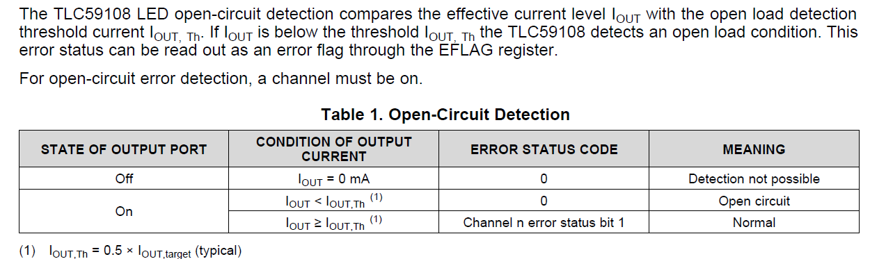

We are having trouble with the open circuit detection feature. Can you describe the register settings and what status should we expect for closed and open circuit? We are using channels 0 to 5.

Sorry, I have missed your second question.
As I have answered in the first post, the error code of EFLAG register has been clarified clearly in the Table1 of datasheet, as well as the condition.
Please respect every answer.
If you have any difficulty in reading this, I suggest that you can contact with the corresponding FAEs for more direct help. They can explain to you in a more direct way.
Thanks.

Do I need to set a value for Iout,th ?
Damien
Hi Charles,
Do I need to set the Iout,target with a register or just with the Rext ?
Is the system making an analog comparison to half of the Iout,target?

If the system is making an analog comparison should the open circuit detection funciton for ANY value of Iout,target?
Yes.

Is there a minimum value for LED current below which the open circuit detection will not function?
Can you give me an example of a circuit, register settings and expect values?

Hi Charles,
We are looking into the issue again. Would the open circuit detection work if Rext was 200 ohm ?
Damien
It will work but the Iout,th should be calculated according to the value of Rext.
