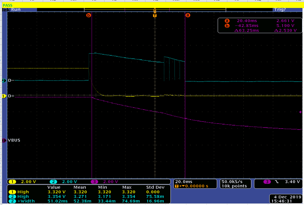

    2. I believe you are experiencing another issue as well. I tested your issue in the lab using the TPS2546EVM and discovered I was running into the same problem, my mouse was not able to wake up the system. The issue only arose when my computer was not plugged in. I am not sure how you are testing, but if your test set up is similar to mine, then the problem is in the computer's sleep features, not with the TPS2546 itself. Here is how I performed my test:
    - Plugged the TPS2546EVM into a computer and plugged a wireless mouse (tested also with wired keyboard) into the TPS2546EVM.
    - I tested this in both supported wake states: 111 and 010
    - Put the computer to sleep
    - Used the mouse or keyboard to wake the computer
    I was only able to wake the computer if my computer was plugged into power. My results of the passing tests are shown below. As you noted, VBUS does not ever discharge when the computer is put to sleep and then consequently woken up. The wake up is attempted at the trigger point on the scope capture.
    111 S0 state:
    010 S0 State:
    My scope captures looked very similar to yours when the computer was not plugged in to power. VBUS would discharge when the mouse was moved to attempt to wake up the computer and the computer would not wake.
    If this is your issue as well, then your solution will be found in changing your computer's wake settings.
    Emma

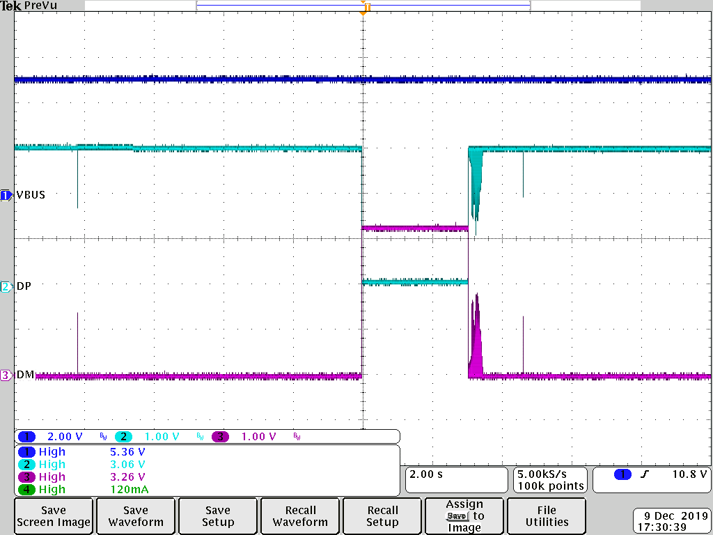

  • Hi Antony,
    After doing some more testing, I found that in the 111 configuration, that VBUS would discharge and the system would never wake up on battery power (shown below) which is different from the issue your customer is seeing.
    So because you are seeing a slightly different issue, please try changing the CTL pins. The system will override the pin change from 111 to 011 and will also override the pin change from 010 to 011.
