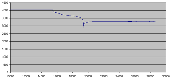

    Your discharge looked like this:
    (mV vs. Sample)
    Note that the battery IS relaxed properly, but the discharge rate is too fast (150mA, as you mentioned above, is roughly C/5 for an 880mAh battery)

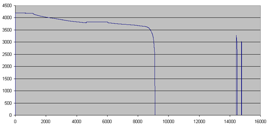

    Also, you never terminate your discharge, and the battery voltage crashes to basically zero.  You need to turn your system off when you reach end of discharge and let the battery relax.  The voltage curve will look more like this:
    Let me know if this helps,
