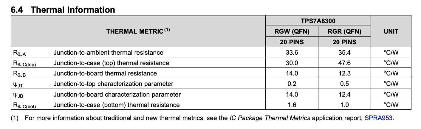

TPS7A8300EVM-209: What is the difference of TPS7A8300EVM-209 & 579?
Part Number: TPS7A8300EVM-209
Comparing both documents, it looks to have a package difference and some crupper layer.
Is there any other critical difference or background?
Thanks in advance.
S.Sawamoto
  • HI Sawamoto-san,
    The -209 uses the 5x5 package and the -579 uses the 3.5x3.5 package. We initially released the 5x5 part but later we were able to release the 3.5x3.5 package.
    The thermal performance between the two is similar.
    I hope this answers your question.
