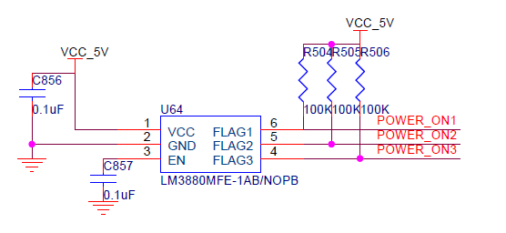

    We made about 80 boards, using the LM3880 to control the power-on sequence. The circuit of the LM3880 is as follows. The input power of the board is VCC_5V.
One board out of these boards cannot be powered up in the chassis.  We find that FLAG1 of the LM3880 on this board hold low,  FLAG2 and FLAG3 hold high. So the power controlled by FLAG1 cannot be powered up.

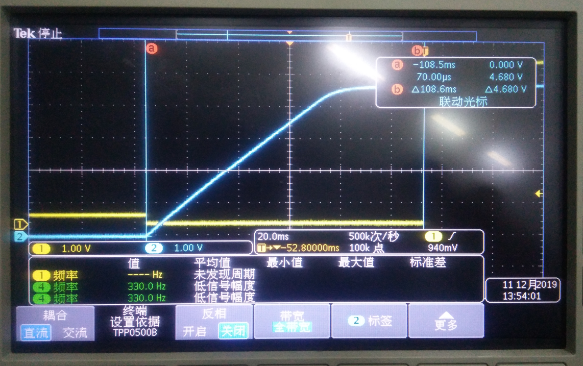

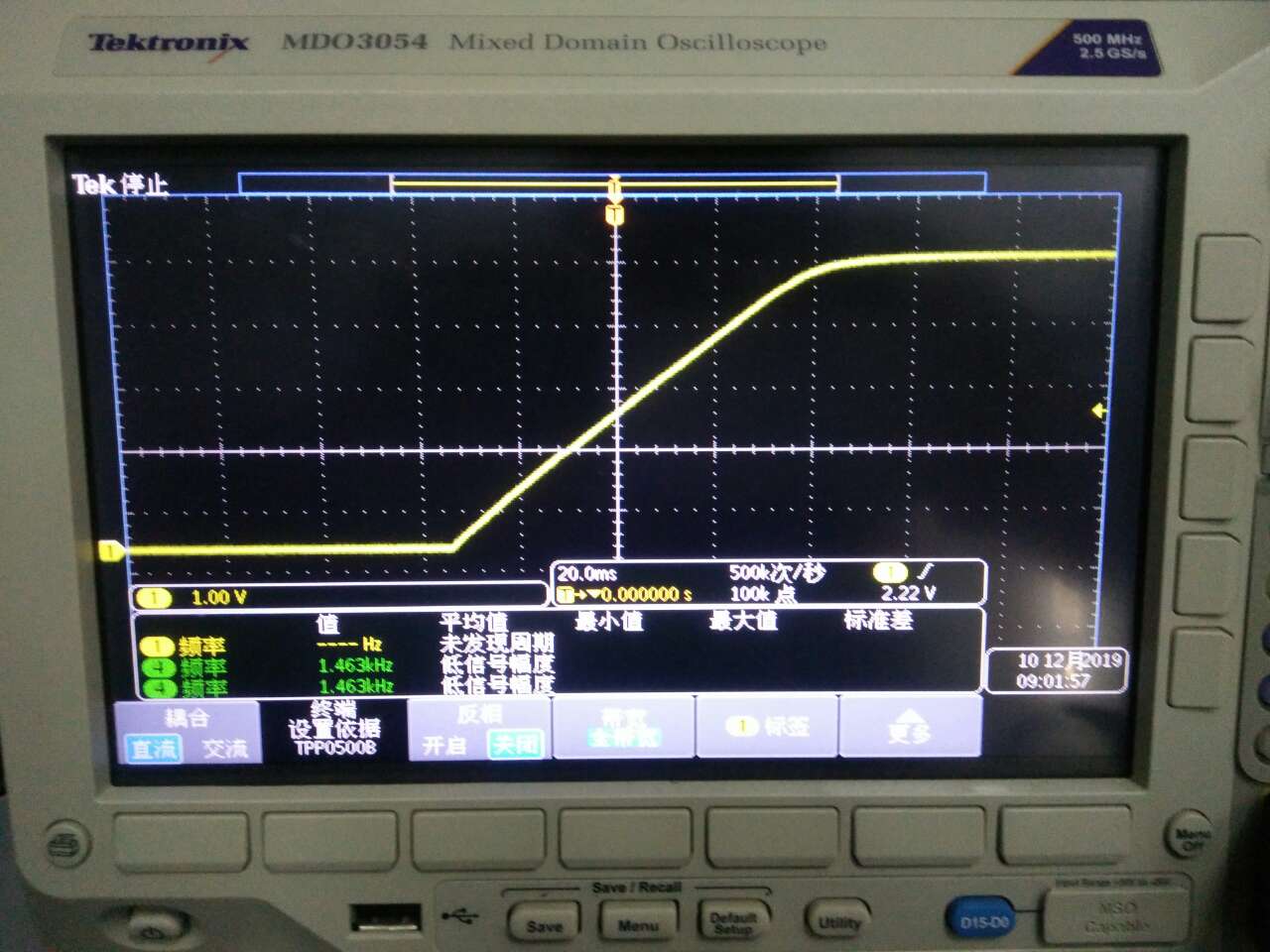

We tested the power-on startup waveform of the power supply. When there is one board in the chassis, startup waveform of the power supply is as follows.

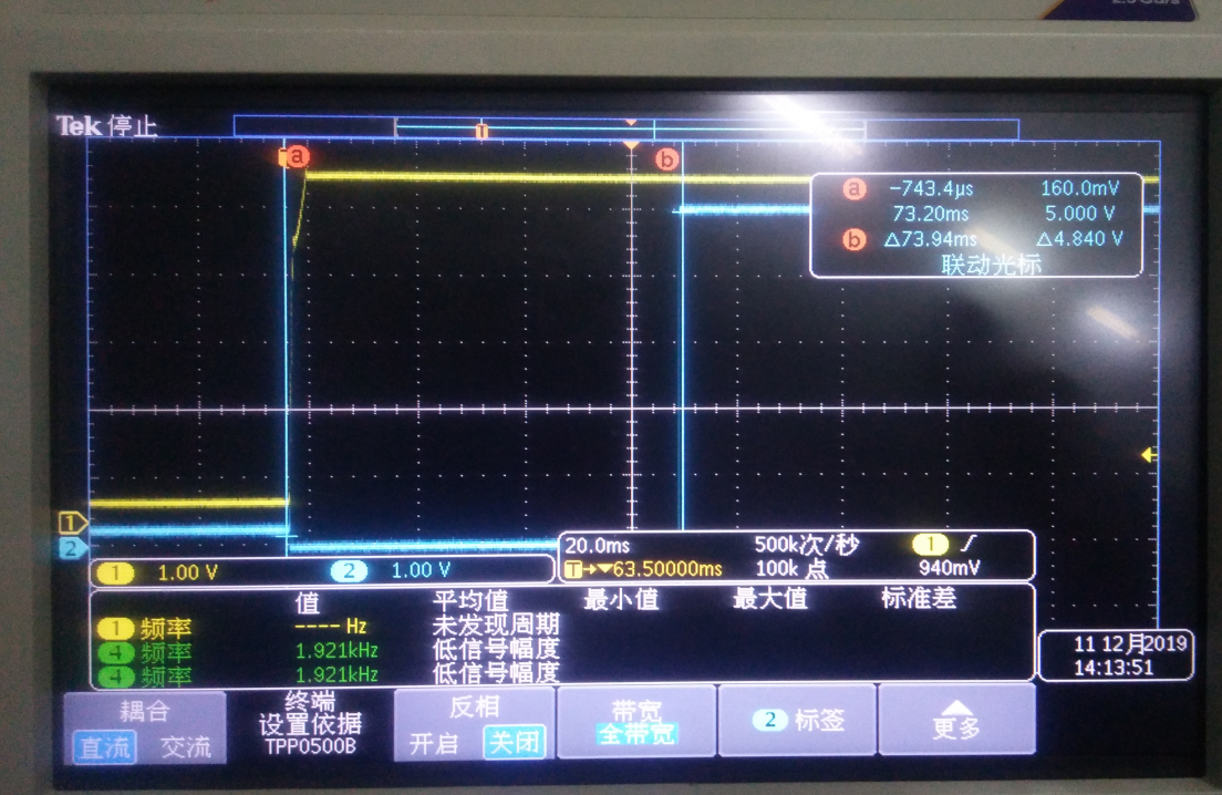

When there are five boards in the chassis, startup waveform of the power supply is as follows.
We can find that when there are five boards in the chassis, temporary voltage drop during power on.

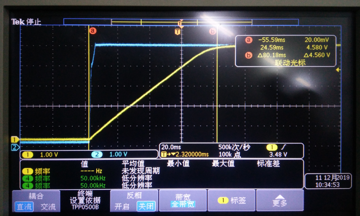

    The startup waveform of the EN pin on lm3880 is as follows.
    It takes about 20ms for EN to rise to ENABLE threshold(1.25V). And it takes about 1ms for VCC to rise to 2.7V.  There seems to be no problem here.

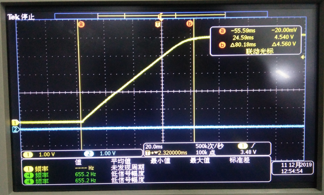

    The startup waveform of the EN and VCC is as follows. The yellow waveform is EN. The blue waveform is VCC.

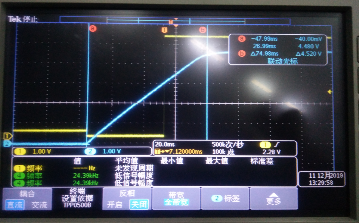

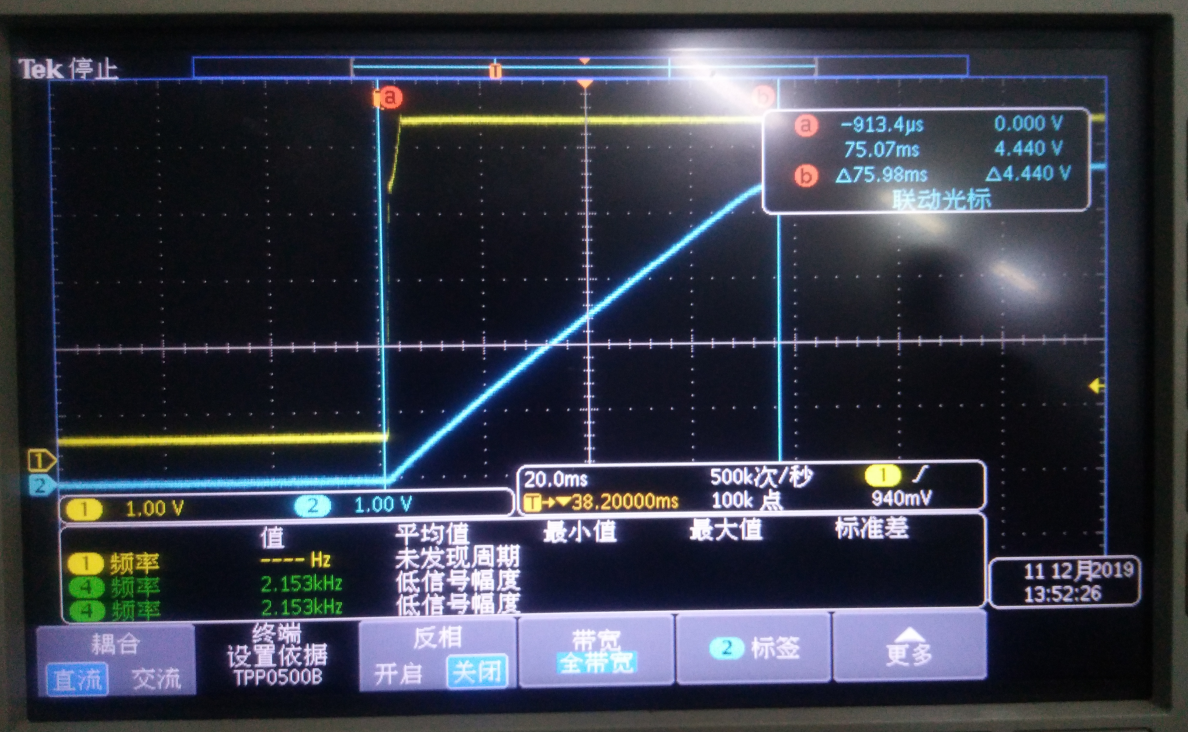

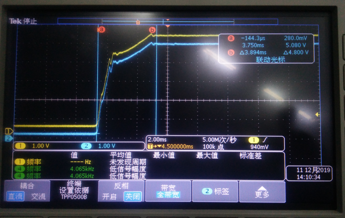

    We tested the power-on startup waveforms of 5V, EN of lm3880, FLAG1, FLAG2, FLAG3 when the abnormal board cannot be powered up. As follows.
    (picture above.  cannot power up. yellow waveform is  EN of lm3880. blue waveform is FLAG1.)
    (picture above.  cannot power up. yellow waveform is  EN of lm3880. blue waveform is FLAG2.)
    (picture above.  cannot power up. yellow waveform is FLAG3 . blue waveform is EN of lm3880.)
    (picture above. cannot power up. yellow waveform is EN of lm3880. blue waveform is VCC_5V.)
    (picture above.  cannot power up. yellow waveform is  VCC_5V. blue waveform is FLAG2.)

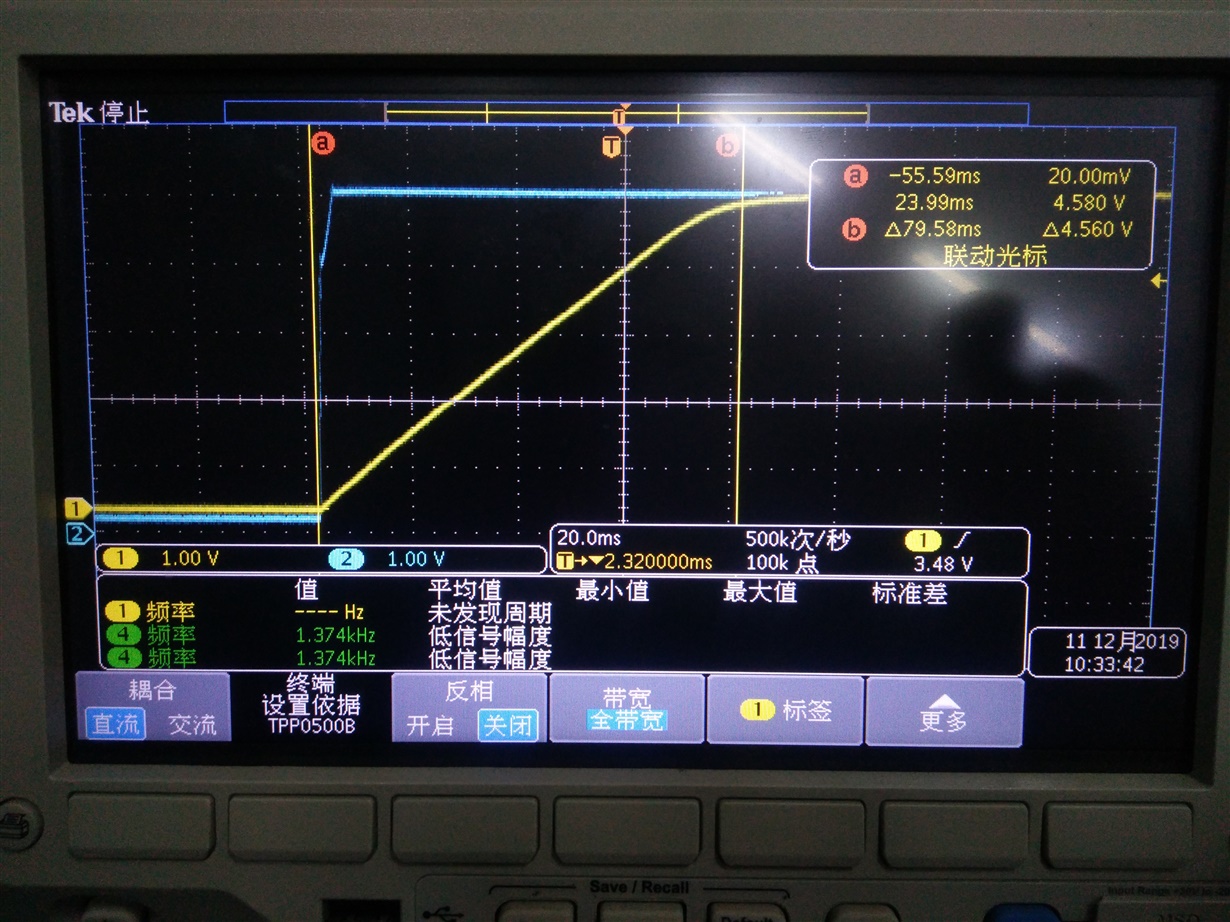

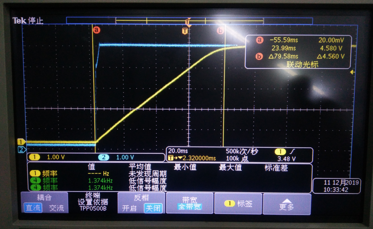

    We tested the power-on startup waveforms of 5V, EN of lm3880, FLAG1, FLAG2, FLAG3 when the abnormal board can be powered up. As follows.
    (picture above. can power up. yellow waveform is FLAG1. blue waveform is EN of lm3880.)
    (picture above. can power up. yellow waveform is  EN of lm3880. blue waveform is FLAG2.)
    (picture above. can power up. yellow waveform is  FLAG3. blue waveform is EN of lm3880.)
    (picture above. can power up. yellow waveform is  EN of lm3880. blue waveform is VCC_5V.)
    (picture above. can power up. yellow waveform is  VCC_5V. blue waveform is FLAG2.)

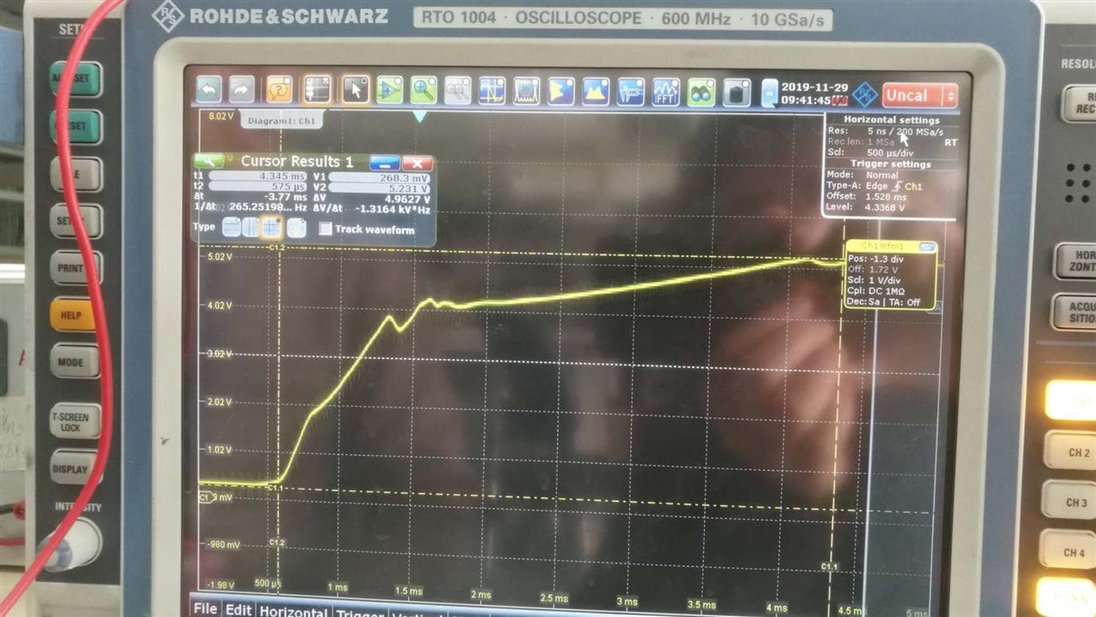

    When used power supply from other vendor, the suspected board is always working when there are 5 boards in the chassis. Power supply from other vendor has longer ramp time and has no voltage drop. Startup waveform of the power supply from other vendor is as follows.
     The power supply vendor said voltage drop is inherent property of power supply, it cannot be fixed unless totally change power supply design.
