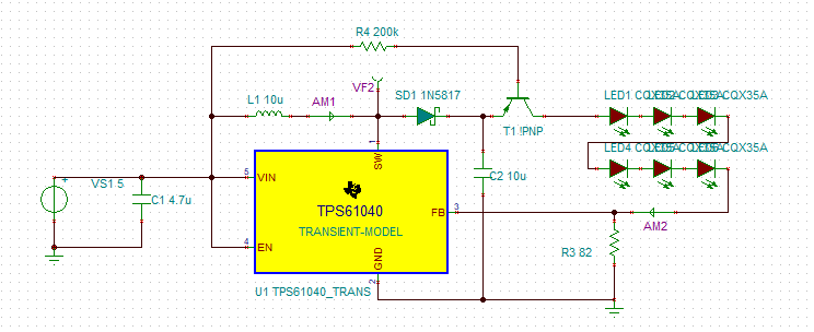

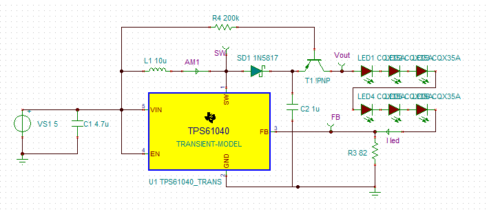

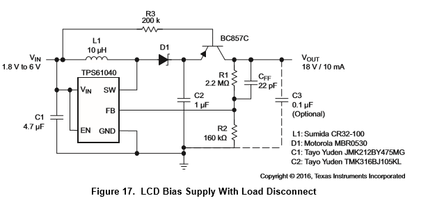

Does TPS61040 could support LED application with load disconnect refered Figure 17 circuit ? I simulate it by TINA, but it failed.

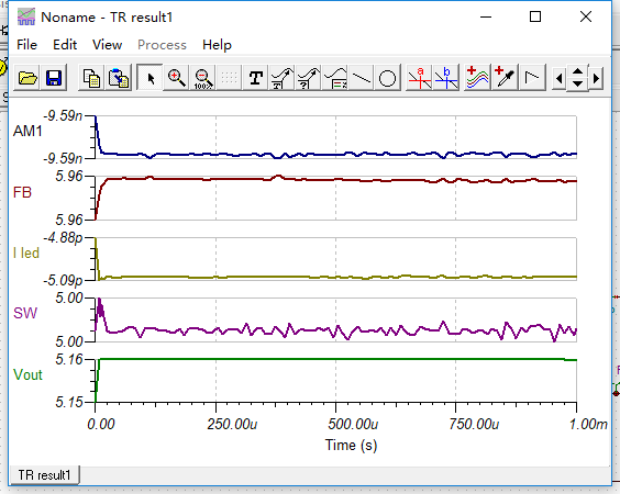

Could you explain more about the failed result and post a simulation waveform result? Thanks.

Your ground under R3 in the simulation schematic is disconnected to R3. After you connect it correctly, your simulation can run. Please have a try.
