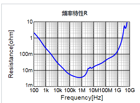

The ESR of the output capacitor should range between 0.3 Ω to 22 Ω.
Capacitor datasheet shows that ESR depends on frequency, so the minimum demand on ESR should base on which frequency ?

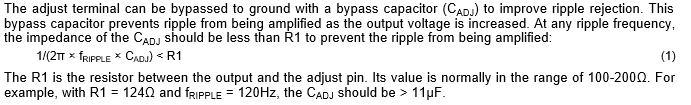

HI Fandy,
This is an example of how we can make our datasheets clearer. fRIPPLE means the frequency of ripple. Please note, the above example is just looking at PSRR (Power Supply Ripple Rejection) at 120Hz. This is the 2nd harmonic of 60Hz AC line frequency. This was used in very old Linear regulators as it was easy to measure.
I hope this answers your question.
