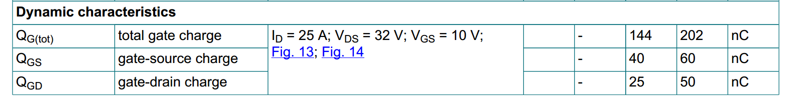

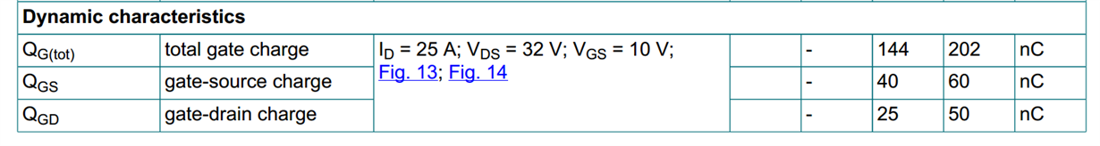

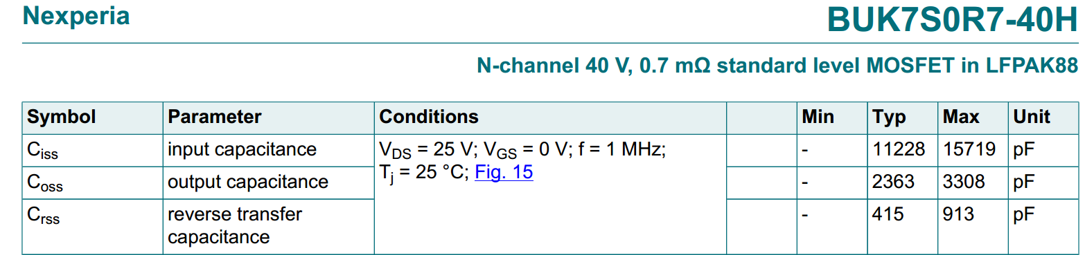

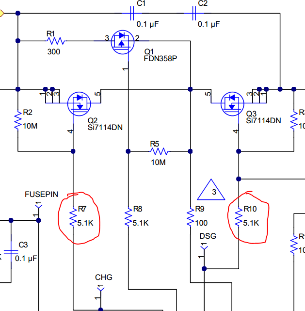

    I use the bq40z50-r2 for 4S-1P LTO BMS,the voltage range:6--10.8V,max current 60A.
   The CHG and DSG mosfet i used with 4 MOSFETS in parallel.
   To improve the switching speed,I want to reduce the series resistance on MOSFET gate,the minimum value i can use is  what?
   the Capacity load between FET gs as the attachment.
