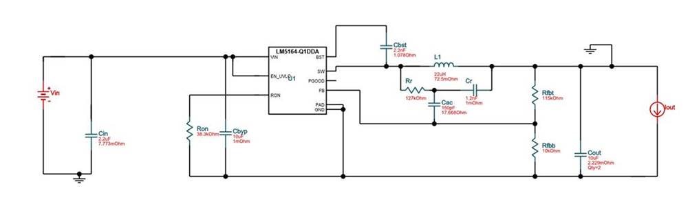

We were using the Webench to check the Phase compensation on the feedback of the LM5164-Q1DDA, and we have a question:
What would be the proper way to set Cr & Cac if we increase Cout?

Take a look at the attached app note and calculator, that should be of some help.
