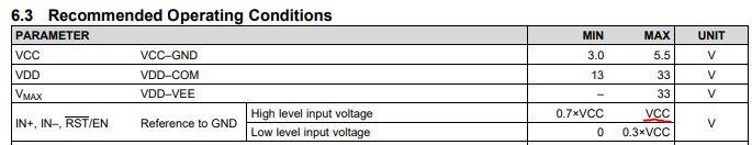

I am aware that the UCC21750 can process both differential PWM pair and single-ended PWM, however, my questions are:
When the single-ended PWM is applied, does the IN- need to be connected to GND?
When the differential PWM pairs are applied, the maximum IN+ and IN- applied is also VCC (5V)?
Many thanks
Weichi
  • Hi, Weichi,
    Thanks for your interest in our products!
    Please read this section in the data sheet for the answer to your first question: 9.2.2.1 Input filters for IN+, IN- and RST/EN
    For your second question, this is addressed in the recommended operating conditions table in the data sheet:
    So, in single-ended input mode, you can ground the IN- pin and drive the IN+ pin up to whatever voltage you have applied to VCC.
