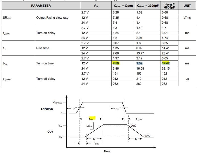

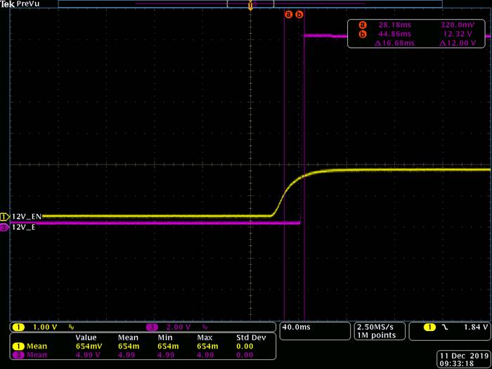

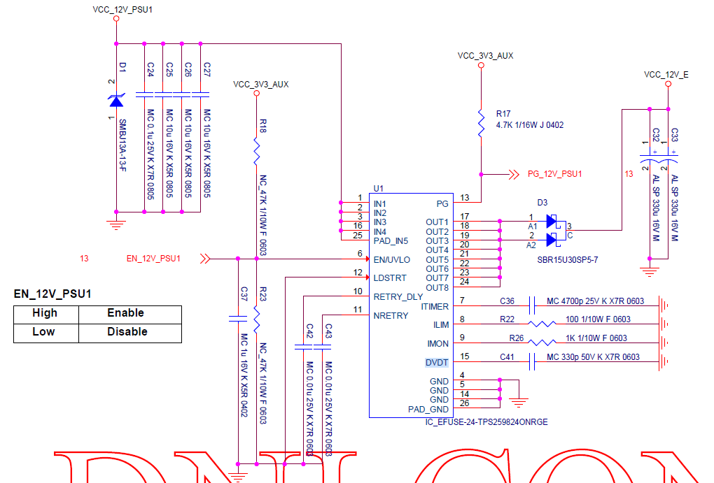

Dear Team
We already remove the Cdvdt cap, but still have long turn on delay.
It should within 3ms, do you have any comments on it?
BR
Kevin
