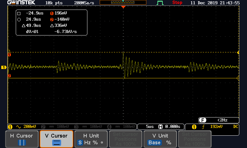

Hi

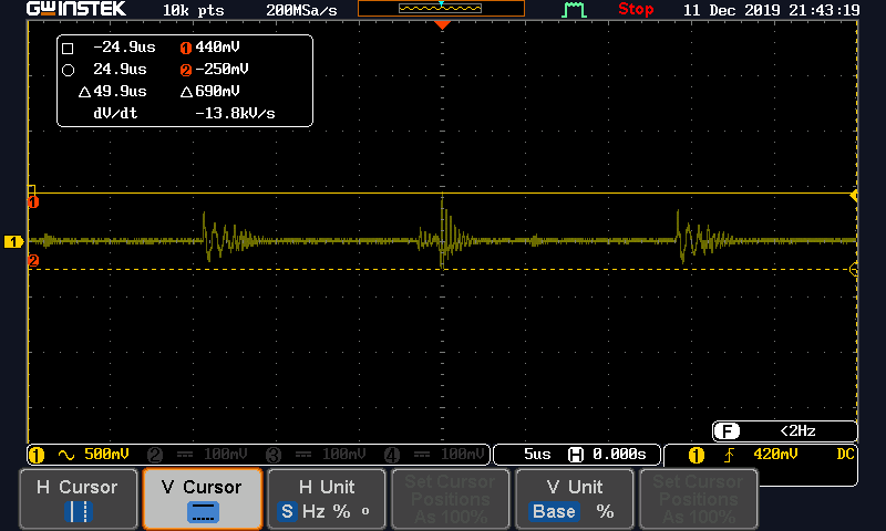

I am getting ringing on output of Power converter of TPS82140SILT,
here i am attaching the CRO screen shot of output with load and without load
On NO Load
ON Full Load
Schematic  Design
  • Hi Tony,
    Generally I do not recommend having a resistor pot to set your output voltage. It is recommended to use 1% resistor components for top and bottom feedback for 5V and 3.3V output. Having a resistor pot would increase your feedback node which would enable noise to couple onto the FB pin and affect stability and regulation. Additionally I would recommend changing your input and output ceramic capacitors from 1uF to 10uF. This should help provide better input and output voltage filtering.
    Jimmy
  • Hi Tony,
    Can you please describe your output measurement technique? Are you following recommendations as described in this video and article?
    Kris
