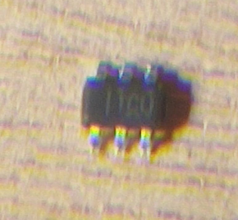

Looks like LM66100 datasheet doesn't describe package marking and the first pin particularly.
How can I get which pin is the 1 from this marking?
It looks like:
But it absolutely unclear which pin si the 1

Hi Leonid,
The line denotes the top of the device. The pin to the left of the line is pin 1.
