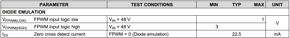

When VIN<Vout(setting) and light load condition, how does LM5161 behave on diode emulation mode?

Diode emulation is not disabled on dropout condition. You can easily use TI-TINA to do some simulations (find its model on below link), thanks.

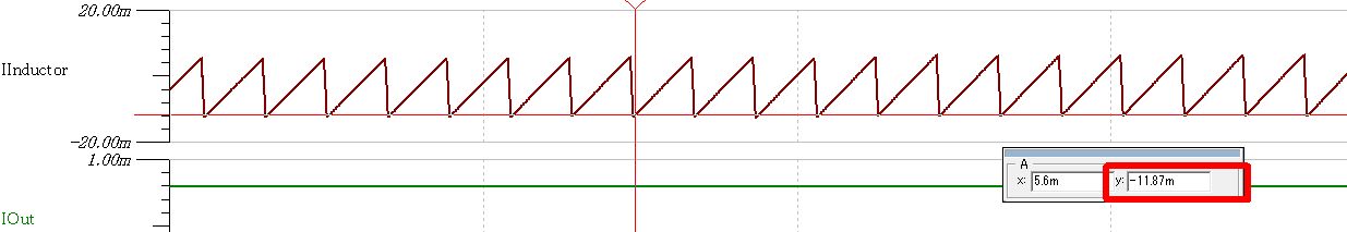

Iven-san,
I confirmed on WEBENCH, IL was achieved negative ampere as below.
Is this condition diode emulation mode?
Kuramochi
