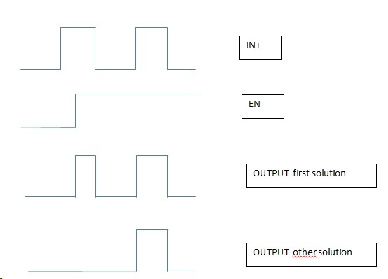

Hi Audrey,
If the EN pin is set to high and if the PWM is not synchronised with the EN pin .
How are the outputs configured ?
Examples below :
Thank you for your help.
