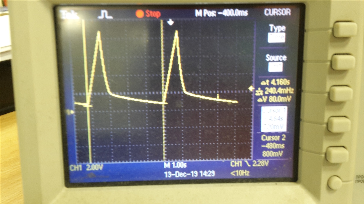

    But with C dVdT = 1000 nF and 100 nF TPS25927 does not turn on at all even without any external load.
    The output voltage rises to ~ 8 V within 1 second (with C dVdT = 100 nF) and then breaks down and after 4 seconds the cycle repeats.
    Why?

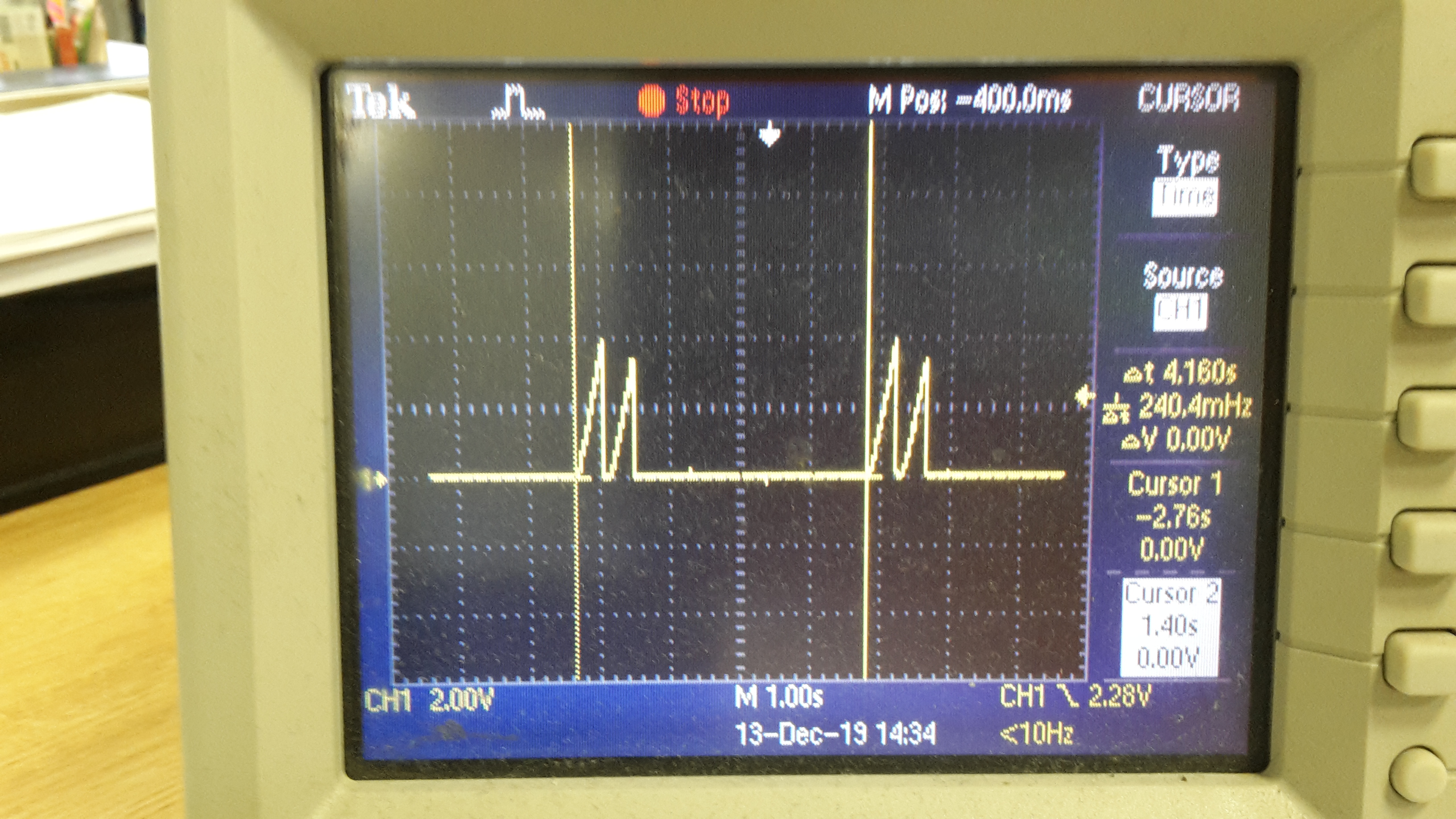

    If you connect an external resistive load of 2 A (7 Ohm - rheostat), then at the output the start cycle will break into 2 small pieces.
    Here, probably, the protection is already working, but it is also not clear.
    The limiting current is 2.4 A and they checked it, It really worked on a 2.43 A purely resistive load (rheostat).

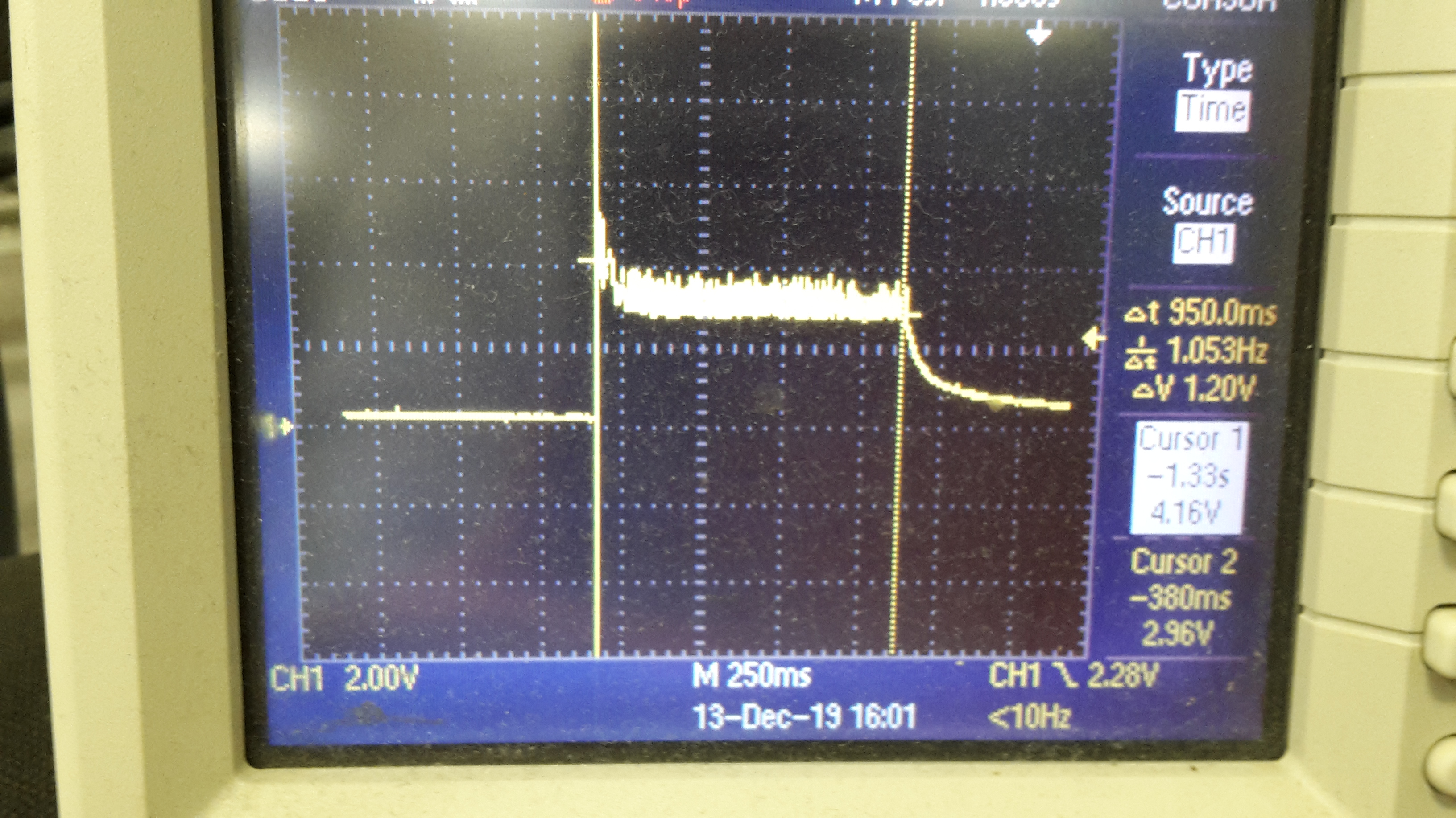

    The last photo: output voltage at start (C dVdT = 1000 pF) with external load by real blocks when they have problem with start.
    Unit load current <1 A

    There shouldn't be any issue in driving a 470uF capacitive load with 100nF Cdvdt cap for TPS25927 if there is no load during startup.
    From the waveforms you shared it looks like the device is hitting Thermal Shutdown threshold during startup and turning OFF. Looking at the Vout falling slew rate of the first waveform you shared, it seems that there is some load as long as the Vout is above 2V.
    Can you share waveforms with Vin, Vout and Iin at above conditions ?
