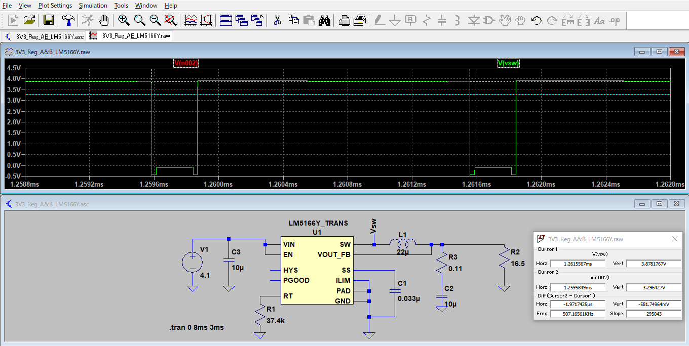

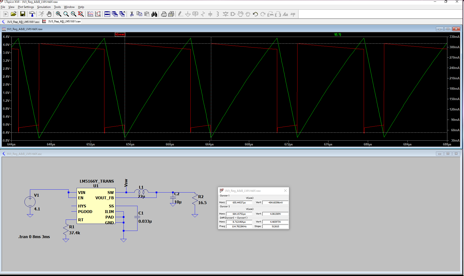

Currently, I am designing 3.3V non-isolated regulator with LM5166YDRCR(COT mode).
Then, I have simulated with LT spice to confrim swicthing behavior.(Spice Model "LM5166_TRANS.lib " that is provided TI web site was used.)
But , Observed switching frequency(SW pin) is 114.7KHz in spicte of Rt = 39.4kohm(According to foumula (4) in datasheet, It should be 478kHz ).
[Schematic]
Please see attached file.
[Question]
1) Why is swicthing frequecy 114.7 kHz, not 478 kHz ?
2)  Would you provide foumula to calculate swicthing frequency under this condition ?

  • Additional infomation.
    I added 0.11 ohm (R3) between Vout and output capacitor in series.
    As the result, I observed that the LM5166Y operates switching frequency appx. 500kHz.( Nearly 478kHz)
    Would please let us know reason why result can be better by this R3 ? and why is R3 needed ?
    Output voltage ripple is critical to feedback loop in COT mode, actual capacitor always has a ESR which brings a certain ripple. That's why you need to add the resistor. Thanks.

    My answers:
    1) Meeting Table 2 is a must for proper working.
    2) Because without a resistor, the inductor current always has a 90° phase shift with the capacitor voltage, the capacitor ripple voltage is used by feedback input so the feedback voltage must decrease monotonically in phase with the inductor current during the off-time. Hence we use a resistor (ESR of capacitor) to achieve this.
    3) Loop will be unstable.
    4) Yes.
