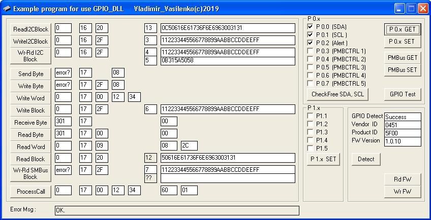

After a lengthy search for the original library for managing USB-TO-GPIO, and not finding one on the Internet, I decided to create my own.
So:
I present to all the abaldenny library !
Drum roll, spotlights in the studio !
  • SMB-to-GPIO.dll
This software and library is designed to organize communication between your VB project and the USB-to-GPIO TexasInstruments module.

The attached archive contains an example of source code for creating a project using SMB-to-GPIO.dll and Firmware EEPROM files for USB-TO-GPIO.
SMB-to-GPIO_28c.zip
