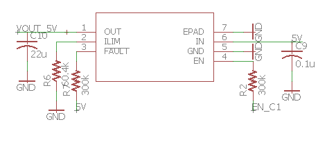

  • Dear Sir,
    When I tested TPS25200, I used 60.4KOhm of resistor then I changed to 47KOhm. And when both of them did not work, I used a potentiometer to change the Rlim,  to see the graph of threshold current wrt Rlim and found that for the value of Rlim in between 15k to 20k, threshold current changes drastically from 500mA to 5A. Also, I used a potentiometer to change the load resistance.
    Below is the schematic of TPS25200.
  • Hi Prashant,
    Can you provide a test waveform of Vin, Vout, EN and input current for ILIM setting of 60.4KOhm resistor.
    BR, Rakesh

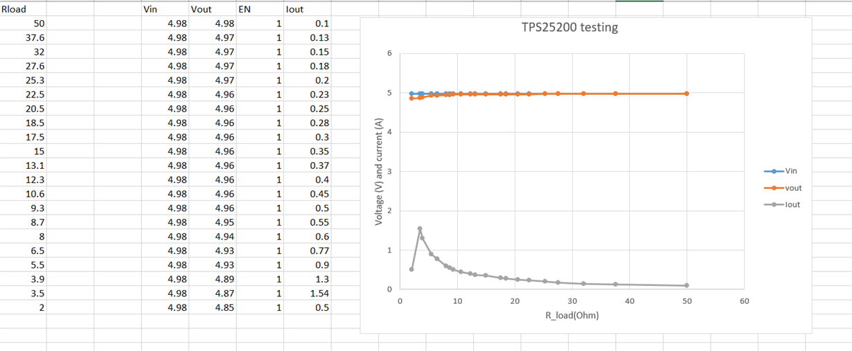

  • Dear sir,
    I am attaching the image, in which I have noted down the Vin, Vout, Iout, EN, and R_load. In this experiment, I have decreased the R_load to increase the current through the load to reach the current threshold. And for the Rlim of 60.4K Ohm, the nominal current threshold is approximately 1.6A.
    In the graph, you can see that when I cross the current threshold limit; the output current gets saturated to 0.5A. But in the datasheet, it has given that after the overcurrent the saturation current should be the threshold current programmed by the Rlim.
  • Hi Prashant,
    Lets take the last case, for Rload of 2Ohm and with 4.85V at output -> you should observe 2.425A  right ?
    Can you use oscilloscope and capture.
    BR, Rakesh

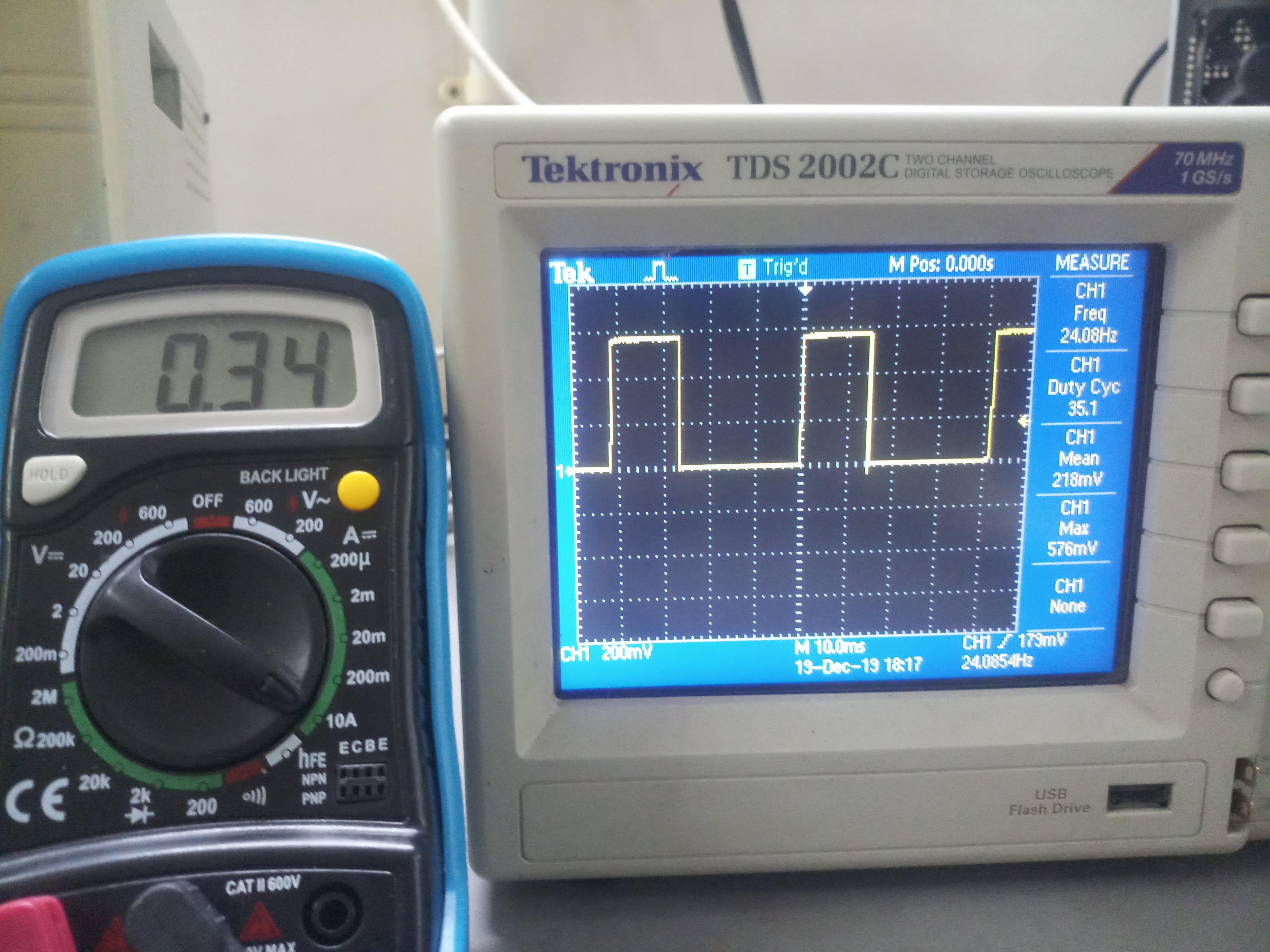

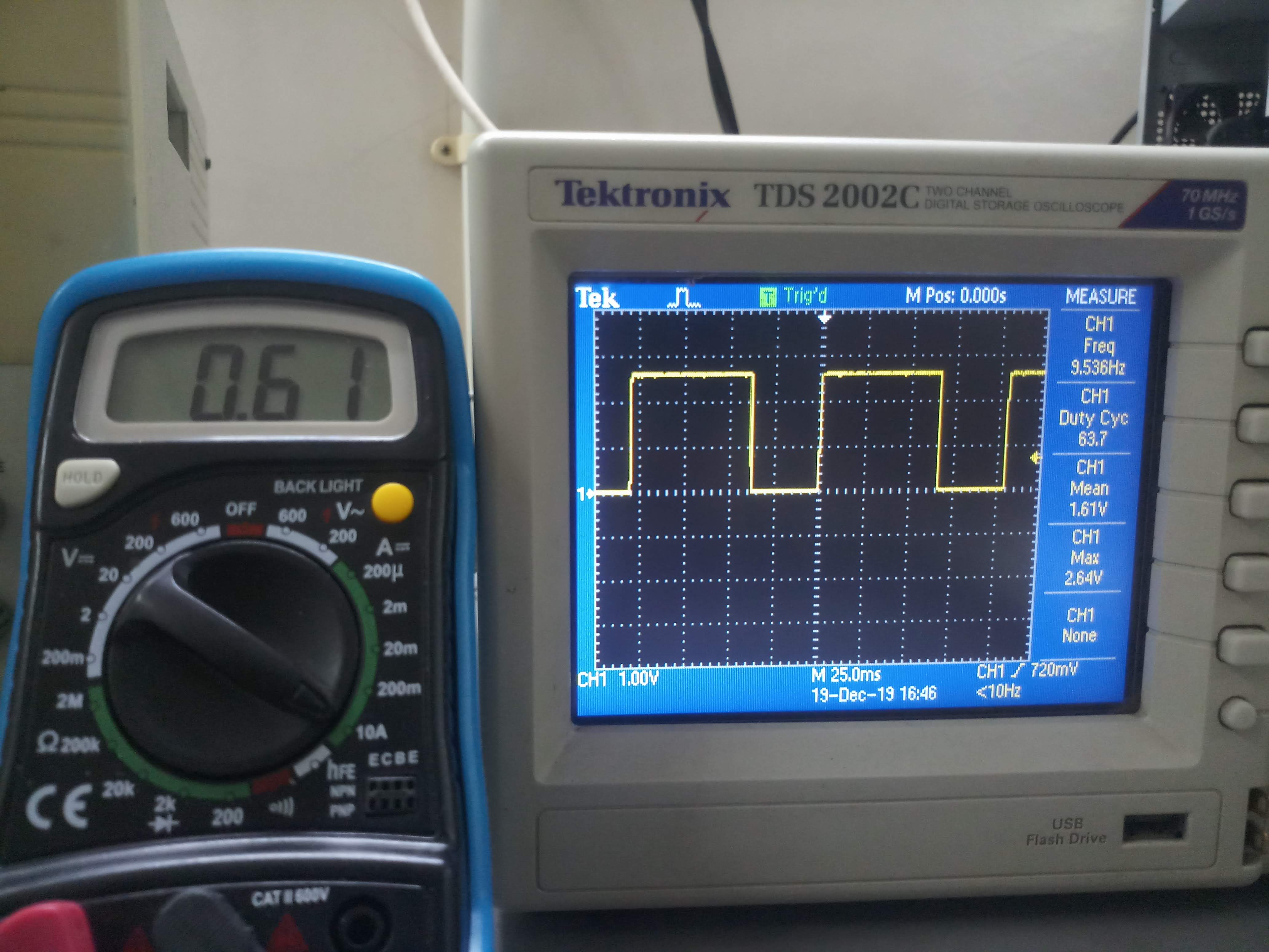

  • Dear sir,
    The previous value for Rload of 2Ohm got misprint. Sorry, for the wrong data.
    I again checked with some different parameters due to the unavailability of components. I changed my Rlim to 100kOhm which corresponds to nom Ios 0.96A.
    Below are the graphs for different values of Rload.  Data on the multimeter represents current and waveform on the oscilloscope represents voltage across Rload
    Case1: Rload=2.6Ohm(approx)
    Case2: Rload=0.6Ohm(approx)
  • Hi Prashant,
    It is doing its job well. The thing is... the device goes into thermal shutdown after operating a while in current limit mode. This is due to the power stress across the device (Vin-Vout)*Ilimit. So, use current probe to measure the real events.
    Please refer http://www.ti.com/lit/an/slva862a/slva862a.pdf for some more details.
    As you see,
    • when Rload=2.6Ohm, the vout = 2.6 * 0.96A = 2.5V
    • when Rload=0.6Ohm, the vout = 0.6 * 0.96A = 0.576 V
