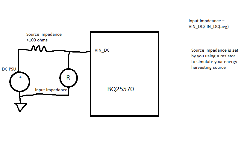

How to measure the impedance of the bq25570 when it is working?
By R=V/I?
Li,
The bq25570 operates in DCM (discontinuous conduction mode). The input current is pulsed to fulfill the MPPT setting. The device goes open circuit to sense the open circuit voltage and then pulses the input current to across the source resistance to regulate the input voltage at VIN_DC according to the MPPT setting.
So to solve for the average input impedance of the device, you must know the voltage at VIN_DC and measure an average input current. Then apply V=I*R to solve for R.
Ricardo
Li,
It is recommended that you use a series resistor (~100 ohm) if you plan to use BQ25570 with a low impedance power source such as a bench top power supply. This value is different than the input impedance of the IC that is equal to RIN_DC(avg) = VIN_DC/IIN_DC(avg).
Ricardo
Thanks. My application is RF energy harvesting circuit. I indeed plan to use a bench top power source. I didn't get the mean of your last sentence. Did you mean using bench top power source, the result equals to RIN_DC(avg) = VIN_DC/IIN_DC(avg)?
