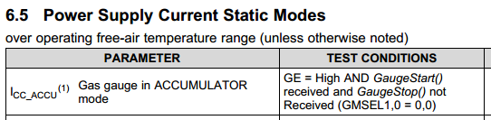

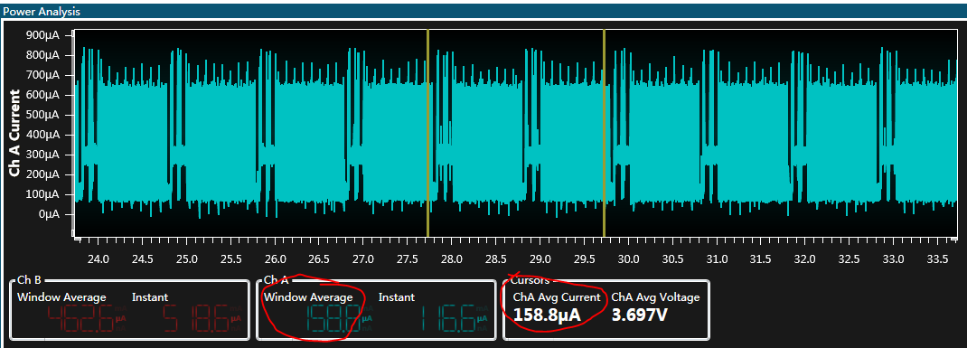

Hi Andy,
I set BQ35100 to ACC mode, the current consumption is about 160uA. Higher than Icc_Accu(130uA) about 30uA
I want to confirm where the 30uA come from. In the spec, Icc_Accu's typical value is 130uA, what is the normal range? Such as 120uA to 140uA? Do 160uA meet spec?

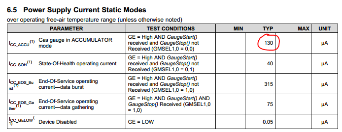

Hi Andy,
For our product is powered by non-rechargeable battery. The power consumption is very vertical.
Where do you get the value 130uA. Is 130uA a measured value or a calculated value? Can it high to 200uA or 300, 400uA?
It runs FW. So 130uA is measured in which version of FW?

It is tough to put the max spec for this device as it runs FW that may or may not do flash writes.
Could you provide the FW that can work in 130uA in ACC mode? Or how to set BQ35100 not do flash writes?
We only use the initial FW in BQ35100 but do not do any modification.
That is the FW you have.
You can refer to the TRM for flash update ok voltage section for the second question.

I suggest you really search or read through the technical reference manual. The questions you ask are all in there.
Here is what I did, a simple search for GMSEL and I found on page 11 of the TRM where this bit is located.
For 130 uA, I'm closing this thread out, you can find the response in multiple threads above.
Thank your for your reply. Page 11 is only for calibration mode. And I can't find the register address of GMSEL in TRM or any other documents.
