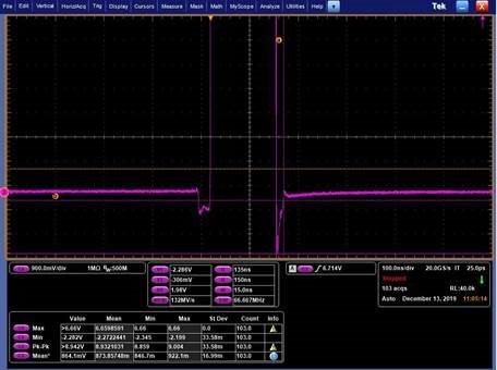

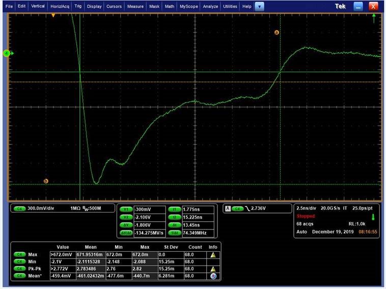

Hi Team,
When testing CSD97395/CSD95373, our customer found that the SW node undershoot less than -0.3V is longer than 10ns, please refer to the waveform below.(They use TPS53626+CSD97395/CSD95373)
On the datasheet, it says that Vsw shouldn't be under -7V for longer than 10ns. Could you please have a look at the waveform above and give some comments about will this undershoot cause any damage to the device?
Thanks.
