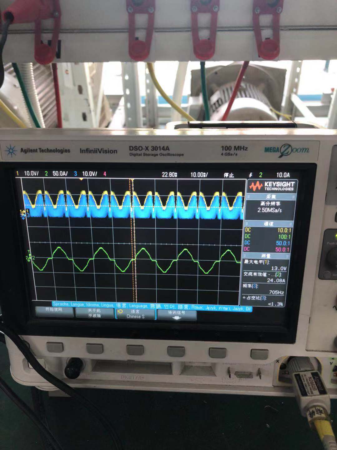

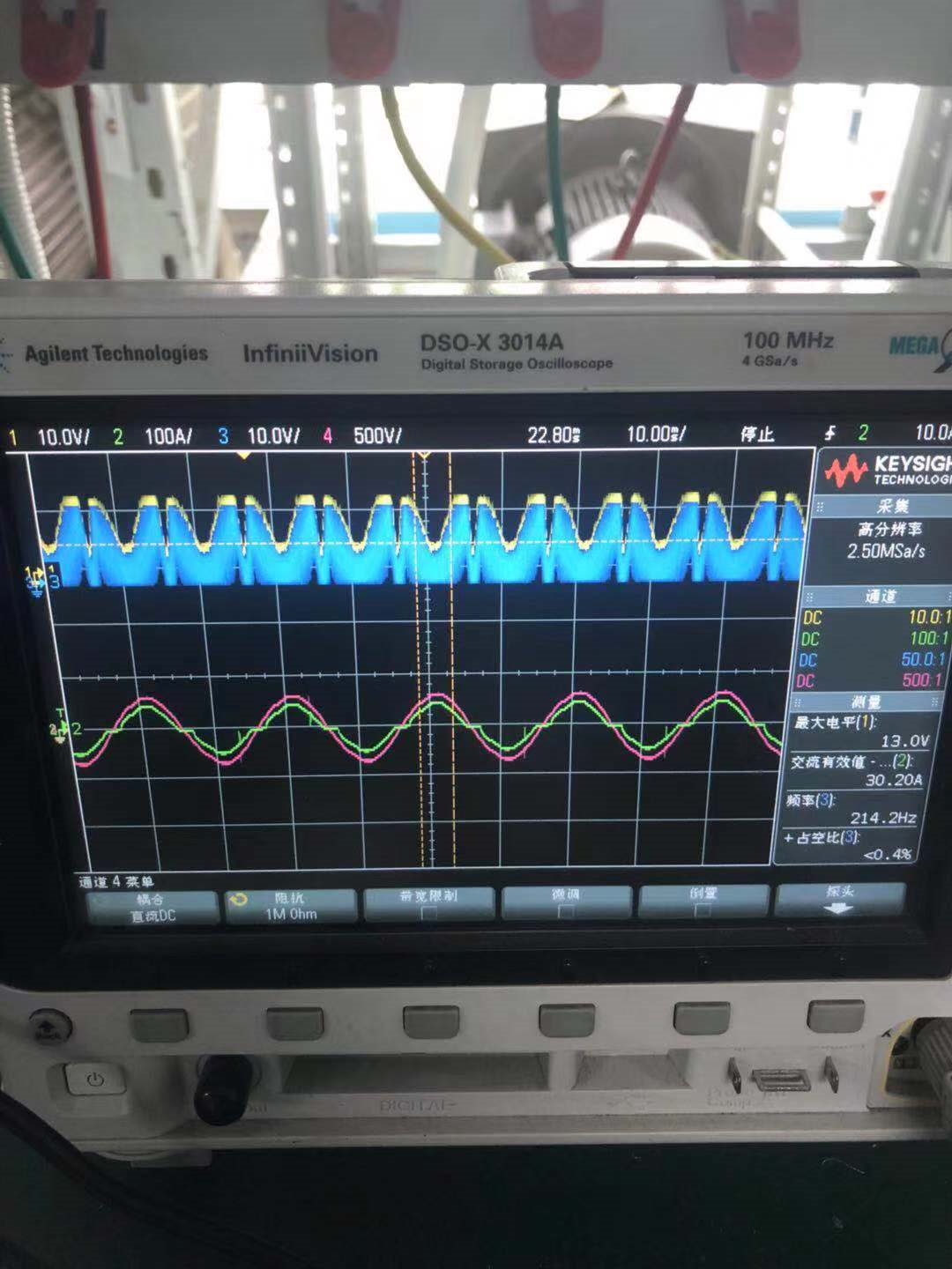

At present, I use your UCC28070 chip to make a 220VAC input, Uo = 390V, Po = 5000W PFC product, F = 65KHZ, Dmax = 0.97. The circuit refers to the TI 5KW circuit. The debugging waveforms are shown in following. At present, the half-load power factor is 0.95 and the 4KW load power factor is 0.985, which does not achieve the expected effect of 0.99 or higher. There are a few points of current questions that require consultation.    1. The current zero-crossing platform is too large (the green line is the grid input current waveform and the red line is the grid input voltage waveform). How to eliminate it, the current dead zone platform seriously affects the PF value increase.    2. How to design if the RIMO increases?    3. How to design Rsyn resistor is more reasonable.

    (1) The input current looks to be distorted.
    This is more likely to be the cause of the lower power factor than the the dead zone around the zero crossings.
    The pfc can be designed for a full load power factor of 0.99 at low line but you will always get a lower power factor as the load decreases.
    You will not be able to get 0.99 power factor at half load.
    If this is a TI reference design you should check the test results and see what to expect.

  • Wave distortion pictures, can they analyze them? What factors may be related for cross zero plat area?
    Any suggestion can we modify to get pure sine wave?
  • Now we  think current  cross zero area is large as picture, How can we improve it?
    Do you need us provide more design specs ?
    We refer TI PMP4311 5KW design.
