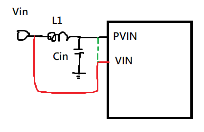

Could you help to recommend where the VIN pin should be connected to if there is a input inductor?
Before L1(red line) or after L1(green dash line)
Thanks.
Allen

Allen,
Connect VIN to PVIN. If you are using an inductor on the input make sure to include some electrolytic capacitance between the inductor and the ceramic input capacitors.
