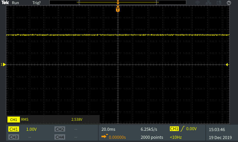

  • Sorry for the delay, I just got access to an oscilloscope today and was able to test measurements based on your troubleshooting steps.
    On one of the working EVMs, I was able to see the pulses (every 250 ms) on the I2C lines that you mentioned. I was also able to see the burst of traffic on the SMB lines of the working EVM when collecting data on bqStudio.
    On the non-working EVM, I only saw a constant signal of 2.5V on the I2C lines. I have attached a screenshot with the output from the I2C lines. I have checked the board and there doesn't appear to be any damaged shunts or contamination. Unfortunately, I was unable to test the SMB lines since the board is not communicating with bqStudio.
    Is it possible that this can be a firmware issue? Based on the Gauge Quick Start section of the User's Guide, I downloaded and installed the bq78350R1 Firmware Bundle (ver1.04) in the "sluc594a.zip" file, but there was an error when installing. I don't recall what the exact error was and now I can't reinstall the firmware because of the "No acknowledgement from device" error message. Are there any steps to reinstall or rollback the firmware to factory settings?
  • Hi Justin,
    Sounds like the gauge has corrupt firmware and is in ROM mode, it will not talk on I2C.  It will error on many normal commands. Usually it can be reprogrammed.  Be sure the firmware installer ran correctly so that the firmware file is complete.  A little more commentary than is in the EVM user guide http://www.ti.com/lit/ug/slvu924d/slvu924d.pdf :

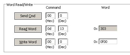

    • Go to the Advanced Comm SMB tab, Read Word 0D.  You should be able to scope the SMB lines for this transaction and read repeatedly as needed.
    If it responds you should be able to program the firmware with the Firmware tab.  If it gives some response other than the 303 shown below, you can send MAC command 0F00 with the Write Word tool, see the technical reference manual section 17.2.58. The 0F00 command only works from normal mode, in ROM mode with the 303 response at 0D it will show an error. If you have entered ROM mode manually, you may get a message in the firmware tab that it is already in ROM mode, acknowledge if necessary.
