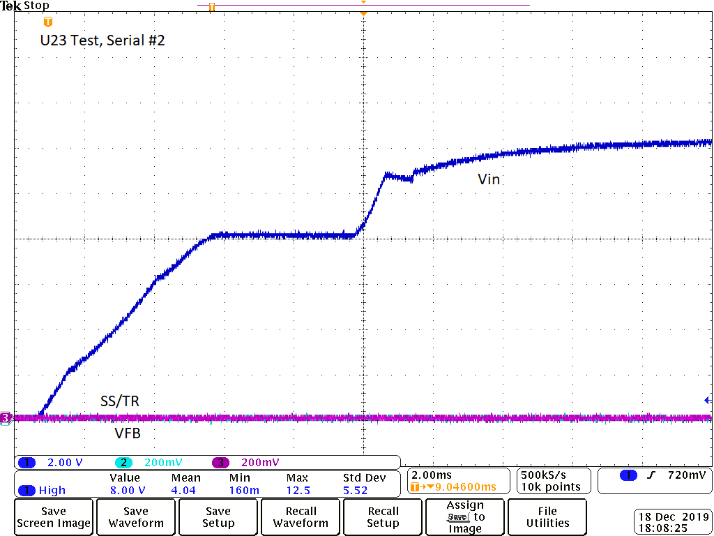

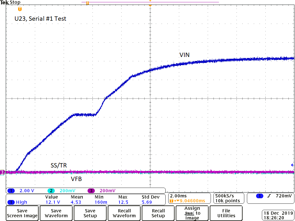

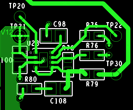

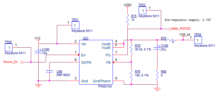

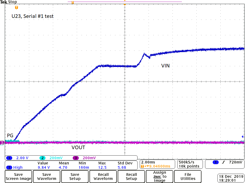

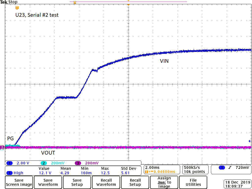

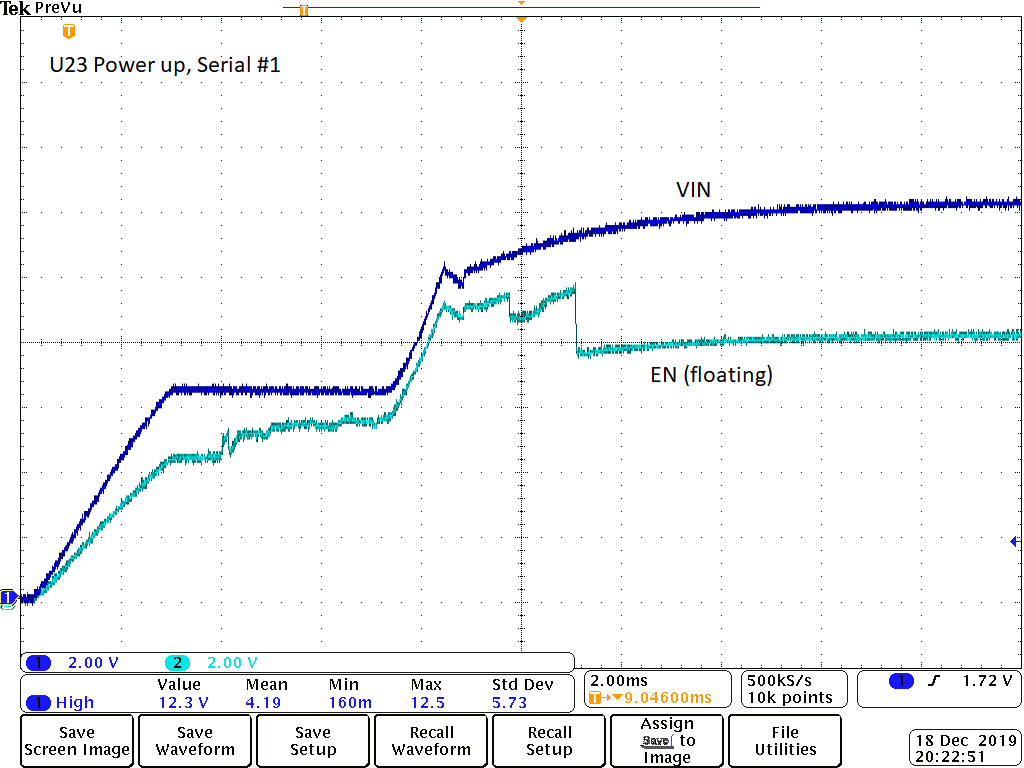

I just received my card card from manufacturing with the following buck converter using a TPS82150. I inspected the workmanship and it appears good. I did some static IRC checks to make sure there aren't any short circuits or cold solder joints and did not detect any issues that way either.
Then I power it up by connecting TP21 and TP20 to a +12V power source with a current limit set at 1A. The output is completely unloaded. The supply powers up and outputs the correct voltage of 3.75V, measured at TP30. Power supply indicates less than 1mA of current draw on the +12V. (V25D supply is un-powered at this point)
I then jumper in some downstream circuits, which consist of about couple of unloaded LDO regulators (LT1763). The current draw on the power supply rises to 2mA and the voltage output drops to about 3.73V or 3.74V. After about 5-10 minutes I look at it again and the output had dropped to ~3.3V and current at the power supply is up to 7mA. I remove the jumper to the downstream circuits and then the output drops to nearly zero (maybe ~110mV). At this point, the device seems to be fried as far as I can tell. Power cycling or anything else I try doesn't seem to help. The chip is not warm to the touch.
This happened on Friday. Then I came in on Monday morning and decided to try again and pretty much repeated the same result (powered up correctly initially then seemed to fail). I tried Monday afternoon and the chip appears to still be dead.
Can anyone offer suggestions on what the issue might be?
